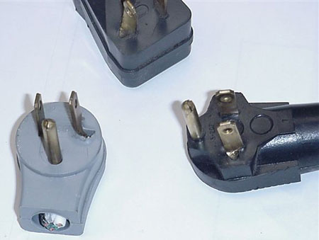

I have come across something I believe is worth mentioning to my fellow newsletter readers. Our plant recently received several microwave ovens from a vendor for use in our vending area. I had the electrician check the units for load, which was found to be 15.8 amps, no problem. However, the electrician discovered that the plugs on the microwaves had been modified. See photo below.
The NEMA 5-20P has been changed to 5-15P. A pair of side-cutters and the twist of a hand is all it takes.
Further investigation revealed almost 20 similar plug conversions in our vending area.
I hope you can let others know to be on the lookout for this. Needless to say this is a serious safety issue, violation of the NEC, and one that could easily result in a fire.
Please do not publish the company or my name.
Senior Electrical Engineer
Mike Holt’s Comment:
The proper solution would be to simply change the 15A rated receptacles with 20A rated receptacles, assuming that the circuit is rated 20A.
