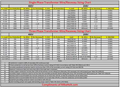

Last month we provided you with a Motor Wire and Protection Chart. This month Mike would like to share with you this free Transformer Chart – should be an excellent tool for use in the office, on the job site, or in a training facility.
Click here or on the image to download the chart. Please print it out, give it a go, and give us feedback on its use and how it can be improved.
On your transformer chart, in the three phase area, you have
3a Wire, 4b Raceway, and 5. EGC while on the 208 volt side,
you have 3b Wire, 4b Raceway and 5. Are these correct and
if so where is the corresponding notes at the bottom as
there is no 3a or 3b and 4a and 4b has to do with wire size
and not raceway. Just a little confusing...
Reply from: Mike Holt January 26 2016, 9:02 am EST You are correct, I revised the single-phase table titles, but not the three-phase. We'll update right away. Reply to Mike Holt

Hi Mike, Could the 15KVA, 208V 3 phase secondary be 60 amps (not 50 amps)to match standard panel sizes?
Reply from: Mike Holt January 24 2016, 12:06 pm EST Yep, can do and will do. I'll send out an updated table in the next few weeks. Reply to Mike Holt
Reply from: Jacob Mendelovici January 24 2016, 12:53 pm EST Secondary 15 kVA Xfmr FLC = 15000 / (1.73 x 208) = 41.69A
a) OCP for noncontinuous load = 42A; next std CB (up) = 50A
b) OCP for continuous load = 41.69 x 1.25 = 52A; next std CB (up) = 60A.
(OCP depends on continuous / noncontinuous load) Reply to Jacob Mendelovici

When you released the former version of the motor tables, I called your attention to the fact that 240.6(A) tells that ?Additional standard ampere ratings for fuses shall be 1, 3, 6, 10 and 601?. Please note that in the updated tables, this was considered for the single-phase motors, but not for the 3-phase motors. Any reason for that?
Jacob Mendelovici
On your transformer chart, in the three phase area, you have 3a Wire, 4b Raceway, and 5. EGC while on the 208 volt side, you have 3b Wire, 4b Raceway and 5. Are these correct and if so where is the corresponding notes at the bottom as there is no 3a or 3b and 4a and 4b has to do with wire size and not raceway. Just a little confusing...
Reply to Mike Holt
Secondary 15 kVA Xfmr FLC = 15000 / (1.73 x 208) = 41.69A a) OCP for noncontinuous load = 42A; next std CB (up) = 50A b) OCP for continuous load = 41.69 x 1.25 = 52A; next std CB (up) = 60A. (OCP depends on continuous / noncontinuous load)

Mike, When you released the former version of the motor tables, I called your attention to the fact that 240.6(A) tells that ?Additional standard ampere ratings for fuses shall be 1, 3, 6, 10 and 601?. Please note that in the updated tables, this was considered for the single-phase motors, but not for the 3-phase motors. Any reason for that? Jacob Mendelovici
Reply from: Mike Holt January 23 2016, 7:34 pm EST
Sorry, will fix my friend!
Reply to Mike Holt
thanks
