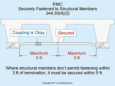

(A) Securely Fastened. RMC must be secured in accordance with any of the following:
(1) Fastened within 3 ft of each outlet box, junction box, device box, cabinet, conduit body, or other conduit termination. Š
Author's Comment:
• Fastening is required within 3 ft of terminations, not within 3 ft of each coupling.
(2) When structural members don't permit the raceway to be secured within 3 ft of a box or termination fitting, the raceway must be secured within 5 ft of the termination. Figure 01
