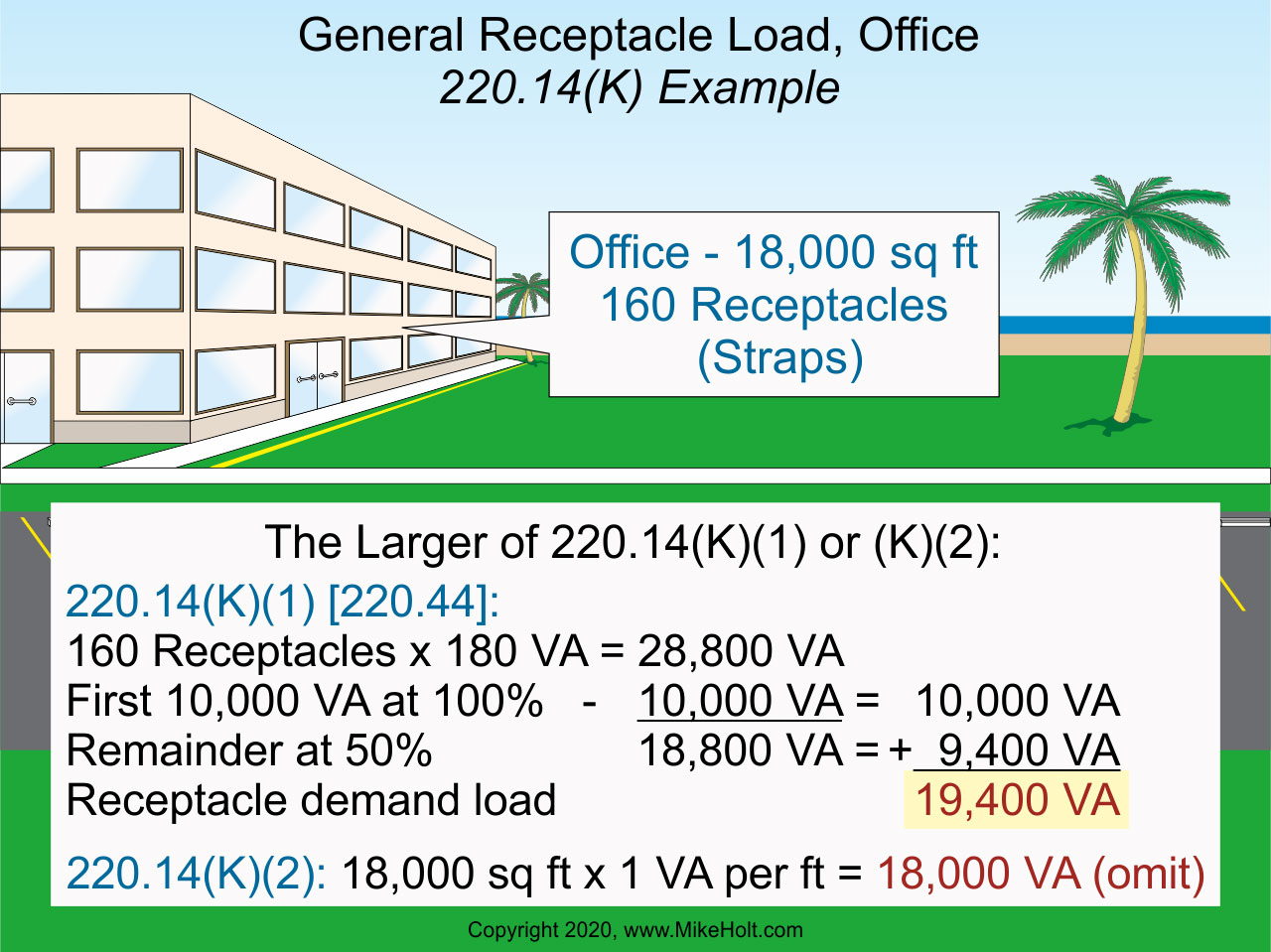

(K) The calculated load for receptacle outlets in office buildings is based on the larger calculation of (1) or (2).
(1) The receptacle outlet load at 180 VA per receptacle yoke [220.14(I)], after all demand factors have been applied.
(2) The receptacle outlet load at 1 VA per sq ft.
Office general receptacle example problem: What is the calculated receptacle load for an 18,000 sq ft office space with one hundred sixty 15A, 125V receptacles? Figure 01
(a) 18,200 VA   (b) 19,400 VA   (c) 20,100 VA   (d) 22,200 VA
Answer: (b) 19,400 VA [220.14(K)(1) and 220.14(I)]
Solution:
160 Receptacles × 180 VA = 28,800 VA
First 10,000 VA at 100% = –10,000 VA × 100% = 10,000 VA
Remainder at 50% = 18,800 VA × 50% = + 9,400 VA
Receptacle Calculated Load = 19,400 VA
[220.14(K)(2)
18,000 × 1 VA per sq ft = 18,000 VA (omit)
