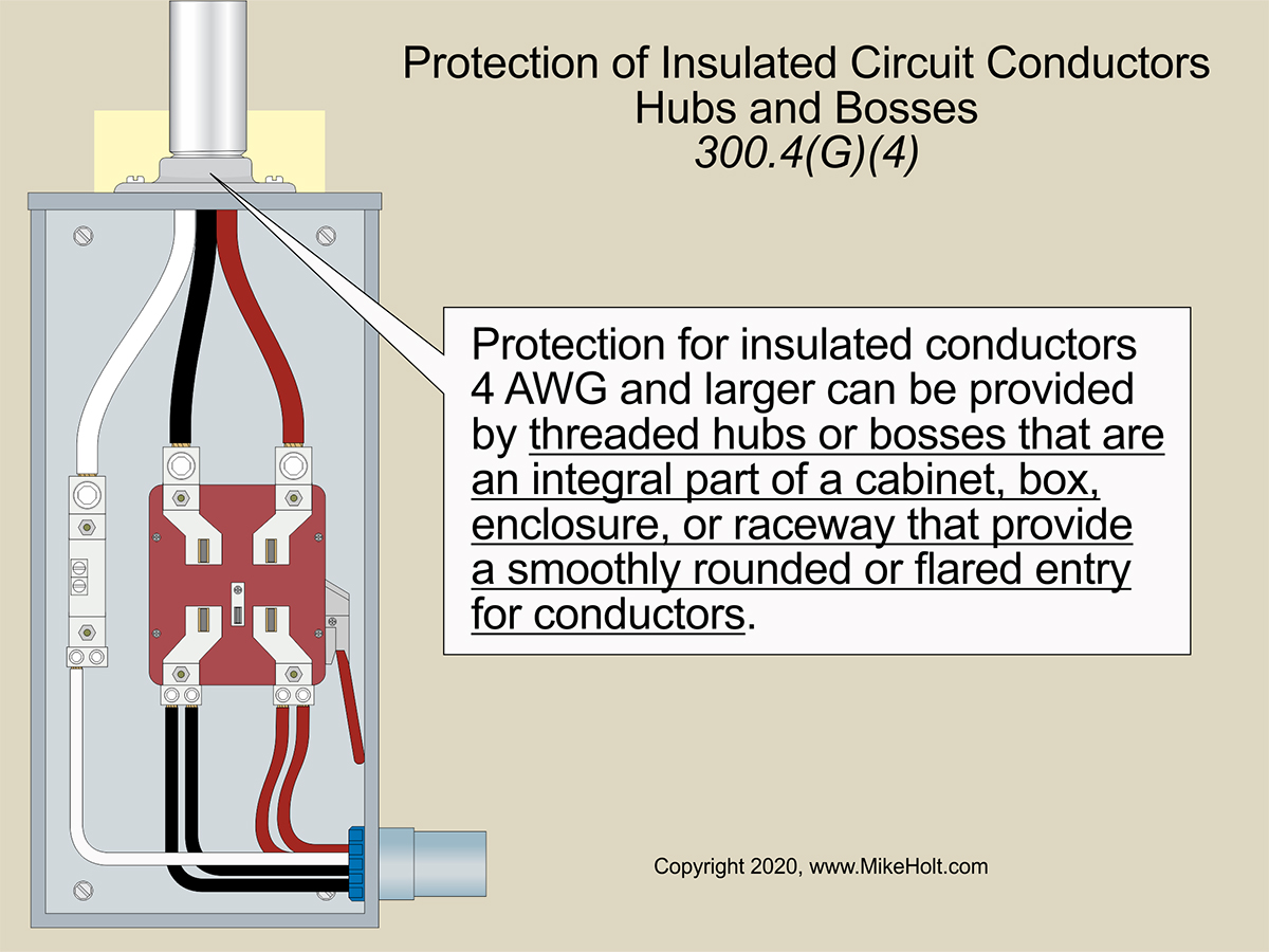

Q1. What does the Code require when conductors 4 AWG and larger enter a cabinet, box, enclosure, or raceway?
A1. Where subject to physical damage, conductors, raceways, and cables must be protected in accordance with (A) through (H) [300.4].
(G) Fittings. Raceways containing insulated circuit conductors 4 AWG and larger that enter a cabinet, box, enclosure, or raceway, must have the conductors protected as follows:
(1) A fitting providing a smoothly rounded insulating surface
(2) A listed metal fitting that has smoothly rounded edges.
(3) Separation from the fitting or raceway using an identified insulating material that is securely fastened in place
(4) Threaded hubs or bosses that are an integral part of a cabinet, box, enclosure, or raceway that provide a smoothly rounded or flared entry for conductors. Figure 01
