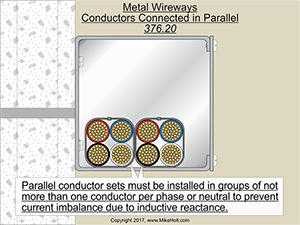

Q4. What does the NEC require when conductors are connected in parallel are installed in metal wireways?
A4. Where conductors are installed in parallel as permitted in 310.10(H), the parallel conductor sets must be installed in groups consisting of not more than one conductor per phase or neutral conductor to prevent current imbalance in the paralleled conductors due to inductive reactance. [376.20] Figure 01
