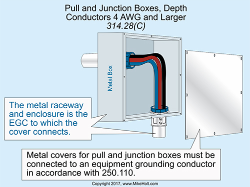

(C) Covers. Pull boxes and junction boxes must have a cover suitable for the conditions. Metal covers must be connected to an equipment grounding conductor of a type recognized in 250.118, in accordance with 250.110 [250.4(A)(3)]. ▶Figure 314“62

Figure 314“62
