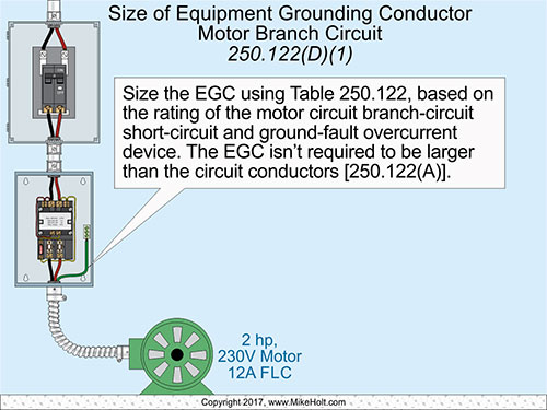

(D) Motor Branch Circuits.
(1) General. The equipment grounding conductor of the wire type must be sized in accordance with Table 250.122, based on the rating of the motor circuit branch-circuit short-circuit and ground-fault overcurrent protection device, but this conductor isn't required to be larger than the circuit conductors [250.122(A)]. â–¶Figure 250“237
â–¶Figure 250“237
Example: What size equipment grounding conductor of the wire type is required for a 14 AWG motor branch circuit [430.22], protected with a 2-pole, 30A circuit breaker in accordance with 430.22 and 430.52(C)(1)? â–¶Figure 250“238
â–¶Figure 250“238
Answer: The equipment grounding conductor isn't required to be larger than the 14 AWG motor branch circuit conductors [250.122(D) (1) and 250.122(A)].
