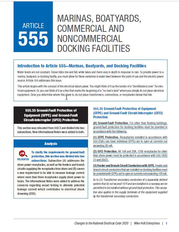

Not enough can be said about the tragedy of electric shock drowning (ESD) and the hazards involved with using electricity around water. Unfortunately, many of the changes or additions to the NEC are propagated by a tragic or near tragic event and these changes should be considered the most significant. One such addition to the 2020 NEC, is a requirement to make available a device to detect and measure leakage current at marinas and boat docks. While there isn't much text in the new section [555.35(B)] itself, there is a ton of info in the Informational Notes that immediately follow.
You can't be serious about electrical safety without taking into consideration the hazards inherent wherever electricity might come into contact with water but to really understand this rule and it's implications, read the attached PDF and make time to watch this important video as myself and a panel of experts discuss this new rule and the informational notes that follow.
For additional information on Marina and Boatyard Safety, visit www.MikeHolt.com/docks.
Click here or on the thumbnail to the left to view or download the PDF of this rule to follow as you watch the video. (2 pages, 69 KB)

First the language about the Ground Fault Protection of Equipment (GFPE) for the receptacle outlets which supply individual vessels is the permissive can rather than the regulatory shall. That being the case I would expect the marina owners and/or operators might take the least expensive compliant approach of installing the 100 milliamperes trip point GFPEs on the feeder and not install individual outlet GFPEs.
I can now understand the difficulties that would be encountered using a highly sensitive ammeter to measure any apparent current in a vessel's external power cord the test current supplied from the marina's electrical system. The vessel under test could have a modest amount of leakage and still put the total of leakage from that feeder over it's 100 milliamperes trip setting.
