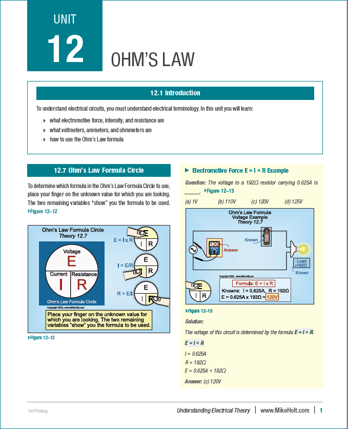

The content below is extracted from Mike Holt's Understanding Electrical Theory for NEC Applications textbook.
Click here or on the thumbnail to the left to view or download the PDF of this section. (2 pages, 350 KB)
Resistance, current, and voltage are all words we use in the trade. Have you ever wondered what they are and how they relate to each other?
The answer is contained in a formula we call Ohm’s Law, “E = I x R” which is the basis for electrical calculations. The math in Ohm’s Law shows the relationship between electromotive force in volts (E), intensity in amperes (I), and resistance in ohms (R) through an electrical circuit.
