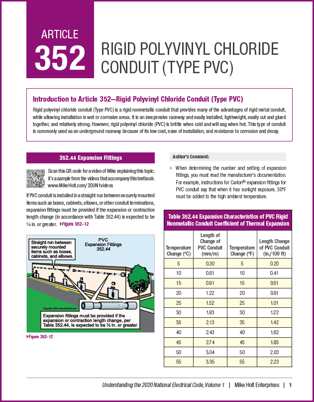

The content below is extracted from Mike Holt's Understanding the National Electrical Code Volume 1, based on the 2020 NEC textbook.
Click here or on the thumbnail to the left to view or download the PDF of this rule. (2 pages, 217 KB)
Ever installed PVC conduit properly secured on the side of a building, and then revisit that installation, only to find the PVC conduit bowing and with broken couplings? Depending on where you are in the country, PVC conduit will be subjected to thermal expansion and contraction when exposed to changes in temperature. To address this issue expansion fittings must be installed in accordance with the manufacturer's instruction.
Do you know the Code requirements for exactly when PVC expansion fittings are required? Find out by reading the attached text and watching the video where Mike and a panel of experts discuss the requirements of NEC section 352.44.
