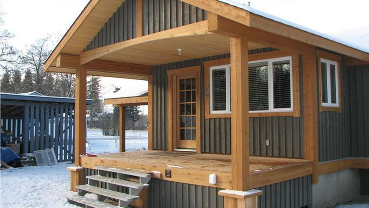

TYPE V: COMBUSTIBULE CONTRUCTION
Non-metallic sheathed cable is permitted in Type V construction buildings for one or two family dwellings [334.10(1),(2),(3)].
In Type V construction the structural elements consist of combustible material. The exterior is usually wood panels and the interior partitions are typically wood framing.
Type V construction buildings are allowed up to 5 stories if sprinkled in accordance with the building code.
• Examples of Type V construction include single family homes and townhouses.
