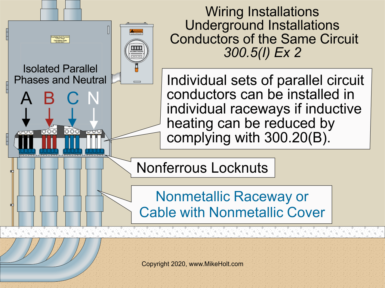

Underground conductors of the same circuit (including the equipment grounding conductor) must be installed inside the same raceway or multiconductor cable, or be near each other in the same trench [300.5(I)]. See 300.3(B).
Ex 2: Underground parallel conductors can have the conductors of each phase or neutral in separate nonmetallic raceways where inductive heating at raceway terminations is reduced by the use of aluminum locknuts and by cutting a slot between the individual holes through which the conductors pass as required by 300.20(B). Figure 01
