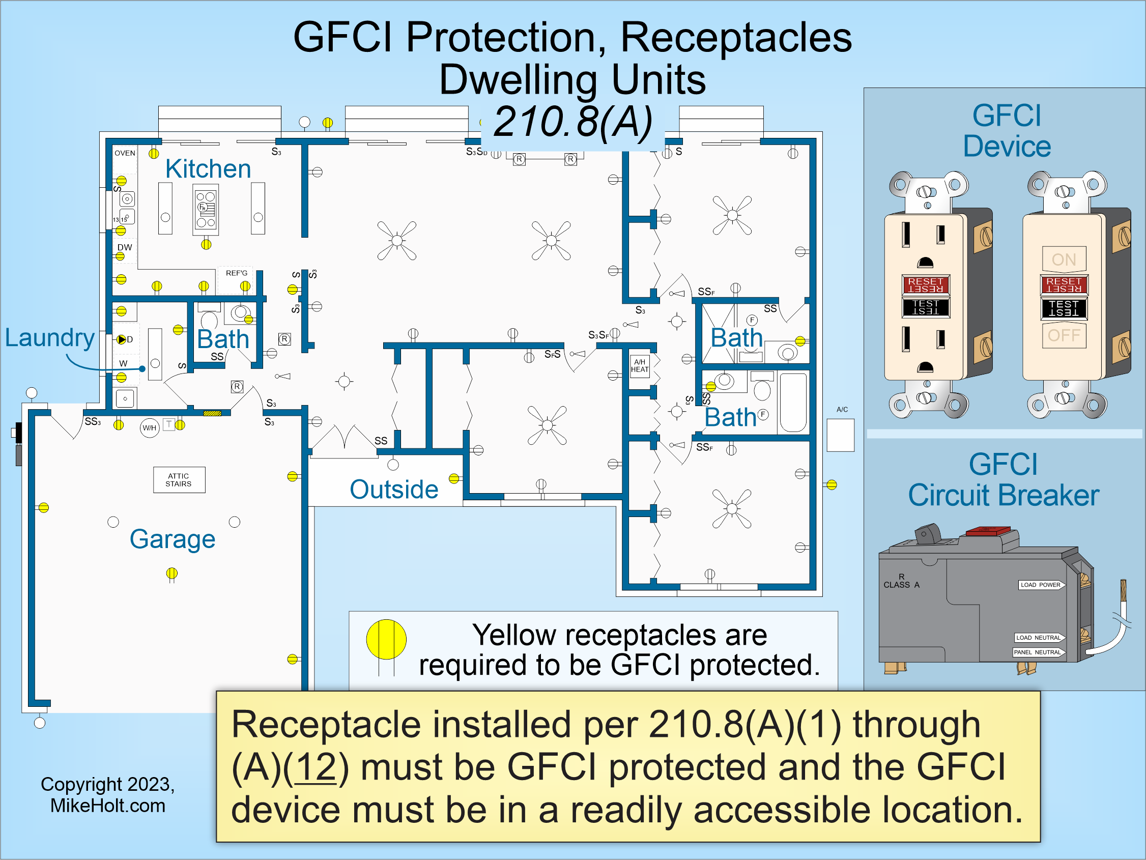

GFCI protection for dwellings
GFCI protection must be provided as required in 210.8(A) through (F). GFCI protective devices must be in a readily accessible location.
You can provide the GFCI protection using either a GFCI circuit breaker or a GFCI receptacle. To apply 210.8(A)(8) or (10), 210.8(B)(7), (13), and (15), the distance you measure from the sink or bathtub/shower is the shortest path the power-supply cord connected to the receptacle will follow without piercing a floor, wall, ceiling, or fixed barrier.
With the 2023 revision, the reference to windows and doors was removed to ensure GFCI protection for receptacles within the measured distance as required in 210.8 even if the measurement line passes through a window or door.
A GFCI circuit breaker provides ground-fault protection starting at the breaker, so the entire circuit has ground-fault protection. A GFCI receptacle provides ground-fault protection for whatever is plugged into it; it has load-side terminals that provide downstream protection for any other receptacle(s) or device(s) on the circuit.
Receptacles installed in the following dwelling unit locations must be GFCI protected (and the GFCI device must be in a readily accessible location) [210.24(A)]. Figure 01

  • The picture needs to be corrected. The receptacle in the hallway needs to be GFCI protected because it is within 6’ of the inside edge of the hall bathroom sink. It’s not highlighted as it should be.
    My question is, can it be on the bathroom GFCI circuit for which code states no other outlets. I’ll have to do more reading for I don’t have the code with me at this time
    Richard  December 30 2024, 8:45 pm EST
    Reply to this comment
  • Reply from: Mike Holt   January 1 2025, 1:43 am EST
    I'll move the receptacles so it's not a question. Thanks and Happy New Year
    Reply to Mike Holt
    Reply from: Mike Holt   January 1 2025, 1:49 am EST
    I'll move the two receptacles so that this is not a question. Thanks and Happy New Year.
