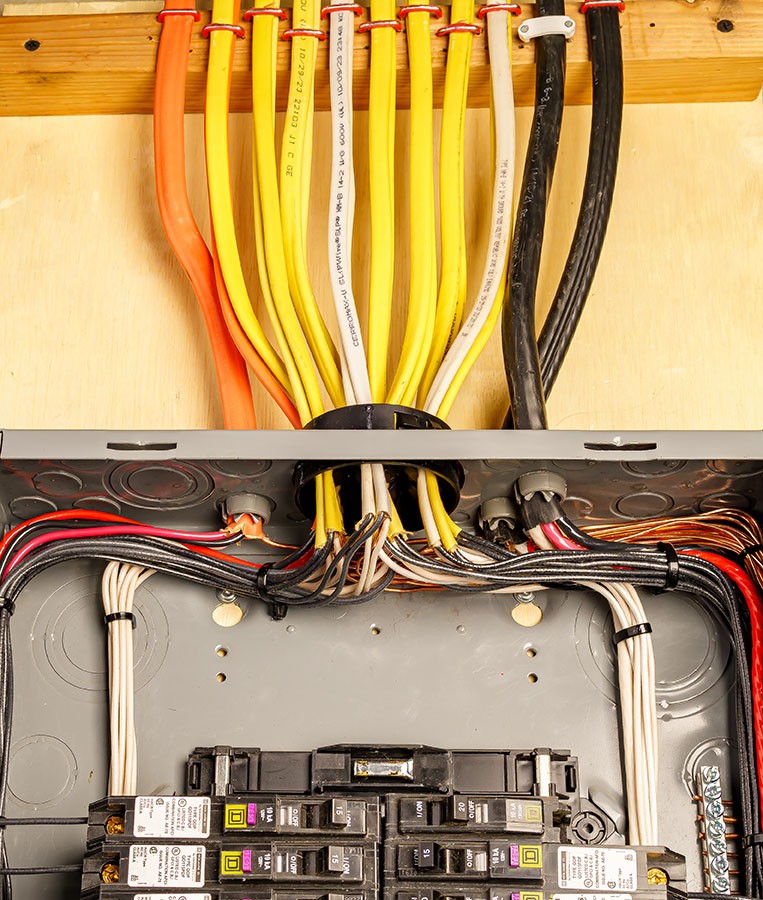

Hunter and his father came up with an idea, born one day working in the field trying to replace an electrical panel on the exterior of a home that had all the cables coming in the back through a single 2" nipple with a bushing. At the time, the inspectors in the area still allowed this type of fitting to be used for replacing exterior panels that were “like-for-like” since there was nothing on the market that met code for the application. They discussed how it would be “so easy” to create a fitting that is ideal for this application and meets code.

That night, March 18th, 2017, I sketched a rough idea of what the fitting could look like. It started with squeezing as many circular 1/2” and 3/4” connectors inside a 3” hole. I quickly found out that small circles inside a larger circle is not a very effective use of available space, so we pivoted to rectangular openings inside the circle to maximize efficiency. With the help of a designer, we produced a CAD (computer-aided design) that seemed very promising.

Making a mold. After the IP was secured, we needed to have an injection mold made. Fortunately, we were referred to a shop in the area that does injection molding and makes high quality molds. Weighing the pros and cons of having an injection mold produced domestic and foreign, we decided to move forward with a mold made locally in the US. One reason for this was protection of the intellectual property as long as possible to reduce the likelihood of knock-offs. Another reason was the quality and long-life guarantee of the mold. The third reason was the ability to have any modifications or repairs done in house and not have to spend 12 weeks turnaround shipping it to a foreign country and waiting for it to return. This was one of our best decisions in the whole process by far, even though the mold cost was 250% above the foreign quotes. The project manager at the facility took a personal interest in this project and has played a pivotal role in the success of the Wire Waffle and meeting UL (underwriter laboratories) standards. We had over 20 iterations and modifications that had to be done to the injection mold to meet UL’s very strict standards. Being able to modify the mold in house made all the difference.
Prior to this process, I had no context for the complexity that is the plastic world. I thought plastic was plastic and we could choose any type that was cost effective and performed properly, man was I wrong! UL has very specific parameters for this application and there are very limited number of plastics that meet the criteria and perform the task up to their standards. It took nearly 9 months of ordering and running different samples of plastics that looked good on paper, but performed very poorly. We were nearly defeated, but the project manager made a call to an “old timer” in the industry who knew of a lesser-known potential option that ended up being exactly what we needed.
Running samples. With the injection mold built and the plastic selected, we ran samples to perform some at home testing to make sure the product was ready for UL’s rigorous testing. They required hundreds of samples of the connector and thousands of feet of cable (US and Canadian) ranging from each size cable we wanted it listed for. They were shipped via a pallet to the testing lab in Illinois. After weeks of anticipation and thousands of dollars invested, we were notified that the connector had failed the tests in all but two cable types. Knowing we would not be able to market the connector with only two sizes of cable, we went back to the drawing board with how to modify the fitting to pass the tests. Brainstorming with the project manager, designer, tool maker, engineer, owner, and myself for a couple hours we were able to come up with some options we thought would work. Some of the modifications made were a few thousandths of an inch, but still necessary.
UL listing. When the next batch was ready to send out, my father and I were invited to UL’s testing facility to witness the tests being performed. We gratefully accepted the invitation and were welcomed to their massive facility. While there we met some of the wonderful people at UL and were immersed into the testing procedures. The stringent and thorough testing process performed by UL makes me realize why it is universally recognized in the NEC and gives me full confidence to install any equipment in the field that is UL listed. We achieved our full UL listing of the Wire Waffle and were eternally grateful for the experience and understanding of the process. Although this was the “cliff notes” version of our experience with UL, it took over 2 years to complete the process.
