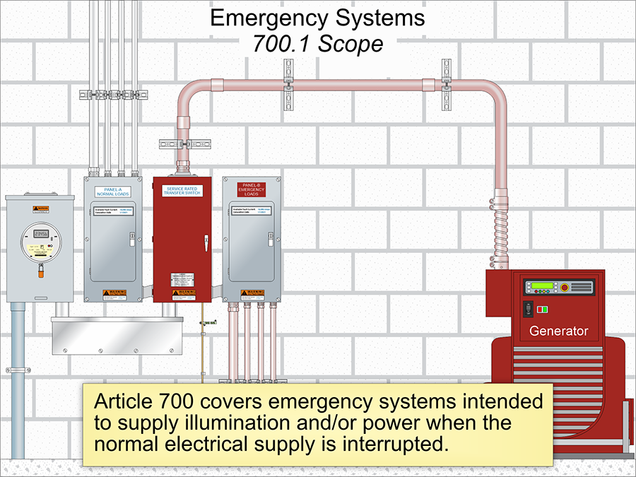

Article 700 covers the installation, operation, and maintenance of emergency systems. Figure 01
An Emergency System must have adequate capacity per Article 220 or by another approved method [700.4(A)].
The emergency system power source(s) can supply emergency, Legally Required System, and Optional Standby System loads where a load management system includes automatic selective load pickup and load shedding to ensure adequate power to each system.
Audible, visual, and facility or network remote annunciation signaling devices must be installed where applicable for the purposes enumerated in 700.6(A) through (D). For example, to indicate the emergency source is carrying load.
Emergency system conductors cannot be installed within any cabinet, enclosure, raceway, cable, or luminaire with nonemergency loads, except as noted in 710(B)(1) through (6). For example, wiring within a traveling cable to an elevator.
Line voltage supply wiring and Class 2 power-limited emergency lighting control devices must comply with 700.10. Class 2 power-limited emergency circuits must comply with 700.11(B) through (D). For example, exposed cable, cable tray, or raceway systems must be marked to be identified as a component of an emergency circuit or system within 3 ft of each connector and at intervals not to exceed 25 ft.
Emergency power must be available within 10 seconds upon failure of normal power. The emergency power supply must be one or more of the types described in 700.12(C) through (H). For example, a generator.
In selecting an emergency power source, consider the occupancy and the type of service to be rendered, whether of minimum duration, as for evacuation of a theater, or longer duration, as for supplying emergency power and lighting due to an indefinite period of current failure [700.12A)].
The emergency power source must be of suitable rating and capacity to supply and maintain the total load for the duration determined by the system design. In no case can the duration be less than 2 hours of system operation unless used for emergency illumination in 700.12(C)(4) or unit equipment in 700.12(I).
