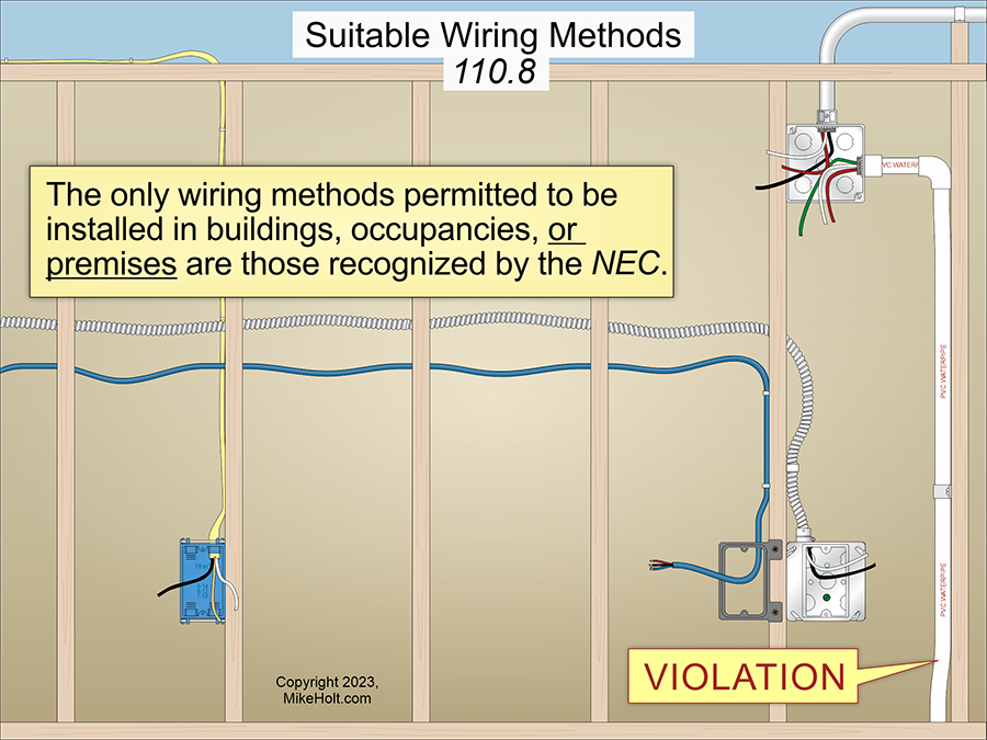

The only wiring methods you can install are those recognized by the NEC [110.8]. Figure 01
