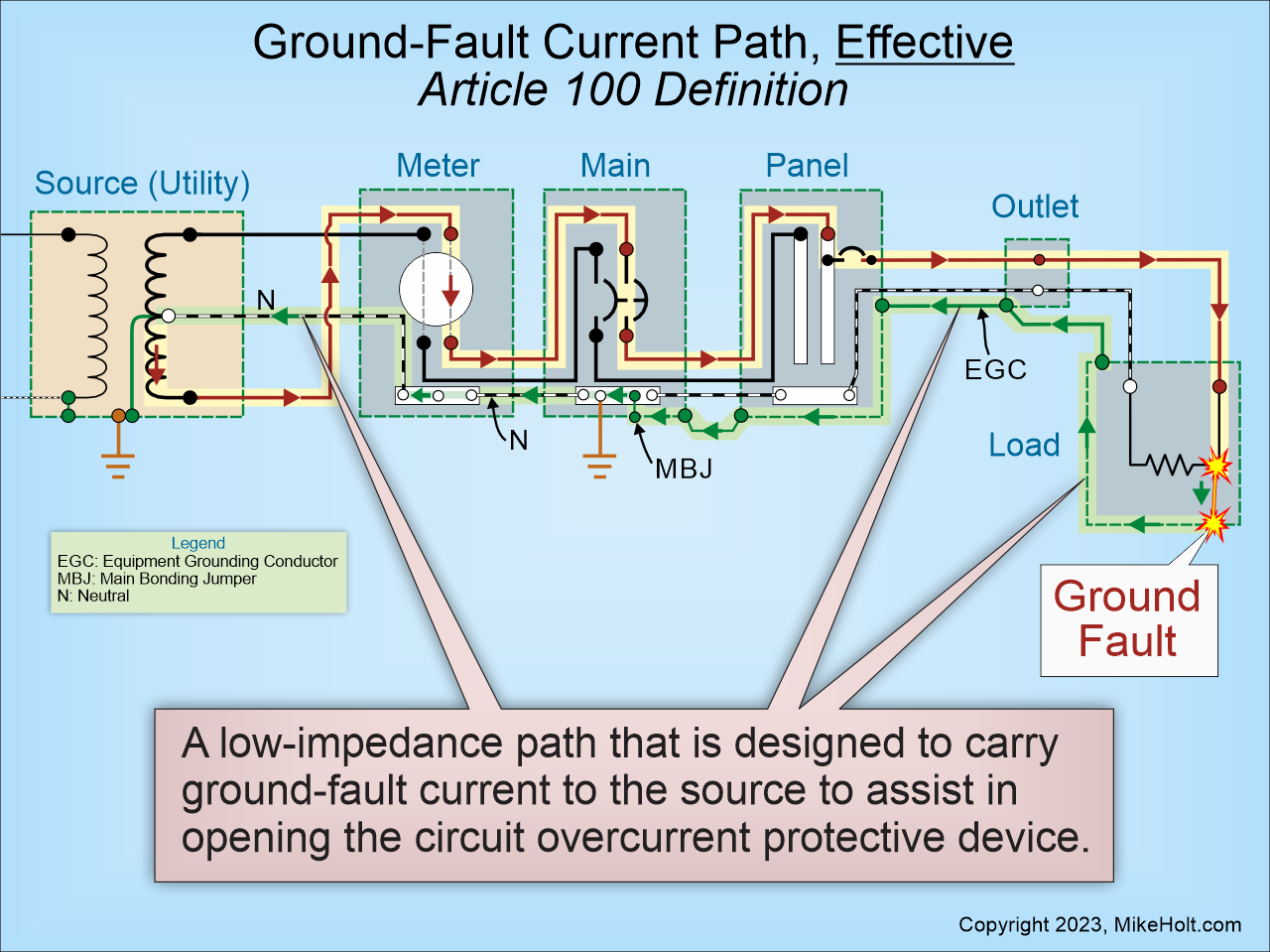

Establishing an effective ground-fault current path
An “effective ground-fault current path” is an intentionally constructed low-impedance conductive path designed to carry fault current from the point of a ground fault to the source. It has two purposes:
1. To open the circuit overcurrent protective device (OCPD) [100]. Figure 01
2. To quickly remove dangerous voltage on metal parts from a ground fault.
The effective ground-fault current path must have sufficiently low impedance to the source so fault current will quickly rise to a level that will open the circuit OCPD. That means it has to be metal. When we use metal to create this path, we call that bonding.
The earth cannot serve as an effective ground-fault current path. Trying to use the earth as an effective ground-fault current path does not remove dangerous differences in potential because the fault return path impedance is so high that very little fault current returns to the source. As a result, the circuit OCPD will not open, and metal parts associated with the electrical installation, metal piping, and structural building steel will become—and remain—energized.
The time it takes for an OCPD to open depends on the magnitude of the fault current. A higher fault current value will result in a shorter clearing time for the OCPD, this principle is called “inverse time”. For example, a 20A OCPD with an overload of 40A (two times the 20A rating) takes 25 to 150 seconds to open. The same device at 100A (five times the 20A rating) trips in 5 to 20 seconds.
Metal raceways, cables, and enclosures that could become energized must be installed in a manner that creates a low-impedance circuit to facilitate the opening of the OCPD [250.4(A)(5)]. And these, along with conductive materials such as metal piping systems and exposed structural steel must be connected together and bonded to the source to establish an effective ground-fault current path [250.4(A)(3) and (4)].
