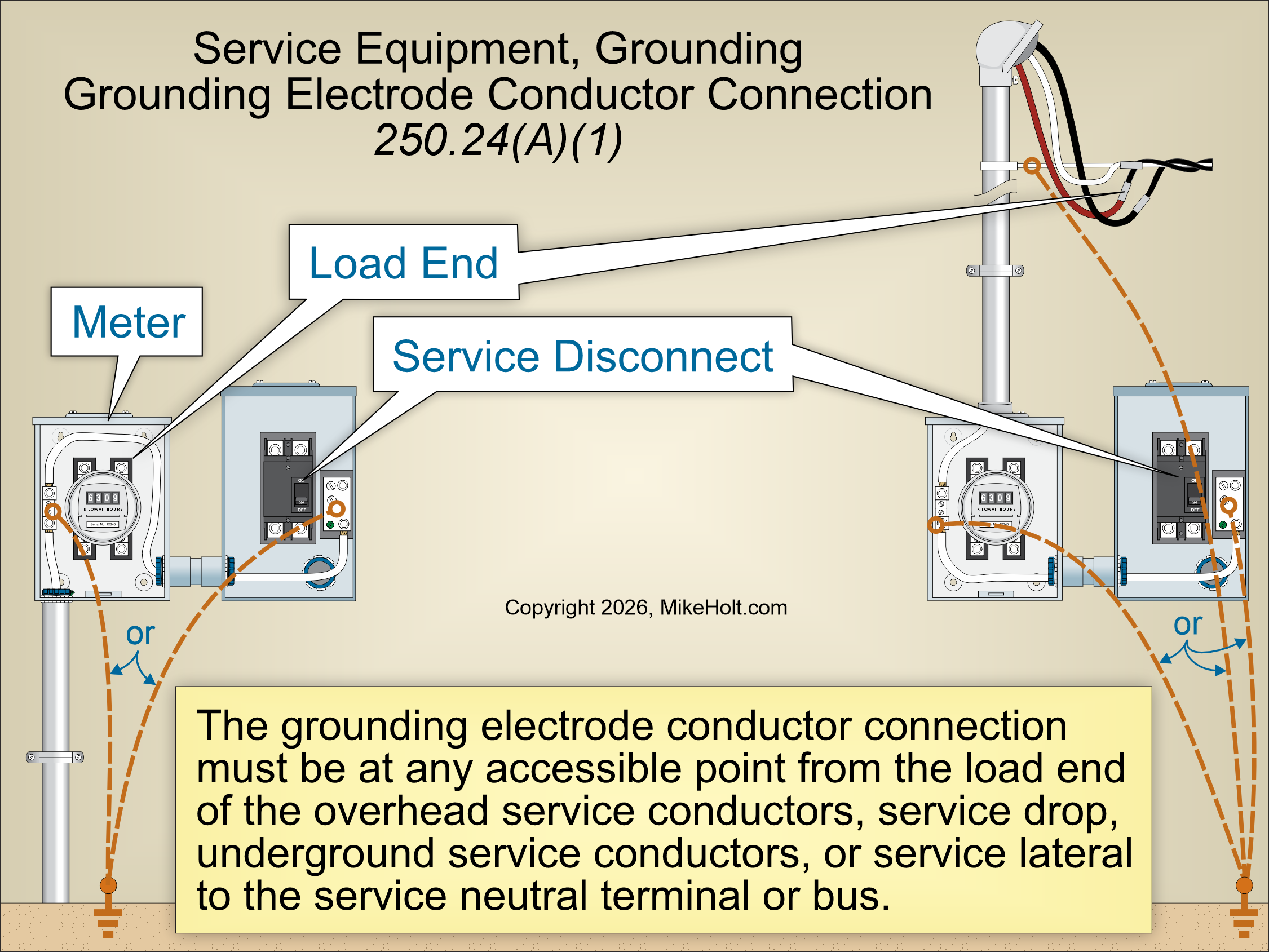

Grounding electrode connection
A premises wiring system supplied by a grounded service must have a grounding electrode conductor connected to the service neutral conductor per 250.24(A)(1) through (4):
(1) General. The grounding electrode conductor connection to the neutral conductor at service equipment must be made at any accessible point from the load end of the overhead service conductors, service drop, underground service conductors, or service lateral to the terminal or bus to which the service neutral conductor is connected at the service disconnect. Figure 01
Some inspectors require the grounding electrode conductor connection to the service neutral conductor to be made at the meter socket enclosure, while others insist the connection be made only within the service disconnect. Grounding at either location complies with this rule, but be sure you know the local utility company’s policy on connections inside the meter socket.
(2) Outdoor transformer. If the service supply transformer is outside, you must make at least one additional grounding connection from the neutral conductor to a grounding electrode.
(3) Dual-fed services. For these, you may use a single grounding electrode conductor connection to the tie point of the neutral conductor(s) from each power source.
(4) Service Equipment, Main Bonding Jumper. If the main bonding jumper specified in 250.28 is a wire or busbar, you can terminate the grounding electrode conductor to the equipment grounding terminal, bar, or bus to which the main bonding jumper is connected, instead of to the neutral terminal.
