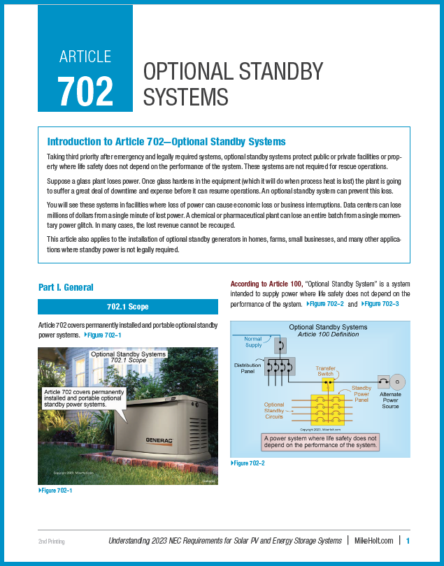

Click here or on the thumbnail to view or download the PDF of this rule. (2 pages, 279 KB)
Did you know that a solar PV system with energy storage can be classified as an optional standby system? An optional standby system has traditionally been an alternative source of power such as a generator. But as technology evolves, the NEC evolves with it. Now, solar PV with energy storage can serve as an Article 702 optional standby system.
Learn what you need to know about what is covered in NEC Article 702 by reading the attached text and watching the video as Mike and a team of experts discuss how all of this is interconnected.
