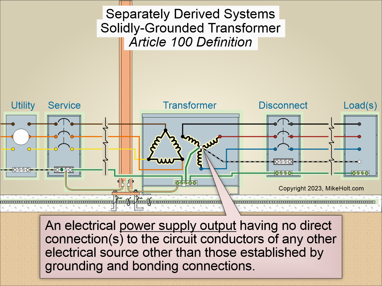

A “separately derived system” (SDS is an electrical power supply having no direct connection(s) to the circuit conductors of any other electrical source other than those established by grounding and bonding connections [100]. Figure 01
Except for autotransformers, transformers are separately derived because the primary conductors have no direct electrical connection to the secondary conductors.
Transformer SDSs must be bonded and grounded per 250.30(A)(1) through (A)(8). On the load side of the bonding jumper, you cannot connect the neutral conductor to:

System bonding jumper
A “System Bonding Jumper” is the connection between the neutral conductor (or grounded-phase conductor) and the equipment grounding conductor, supply-side bonding jumper, or both at a transformer SDS.
A system bonding jumper must be installed at the secondary neutral point or the secondary disconnect neutral terminal (not both). The system bonding jumper must comply with 250.28 and be sized per 250.102(C).
The grounding electrode conductor must terminate to the point where the system bonding jumper has been installed [250.30(A)(5)].
Ex 2: If a structure is supplied by a feeder from an outdoor transformer SDS, a system bonding jumper at both the source and the first disconnect is permitted if it does not establish a parallel path for the neutral current. The neutral conductor cannot be smaller than the size specified for the system bonding jumper, and it is not required to be larger than the phase conductor(s).
A system bonding jumper at the source connects the secondary neutral point of the system to the metal enclosure of the transformer SDS [250.30(A)(1)(a)]. A system bonding jumper at the first disconnecting means connects the neutral conductor of the transformer secondary to the metal enclosure at the secondary disconnect [250.30(A)(1)(b)].
