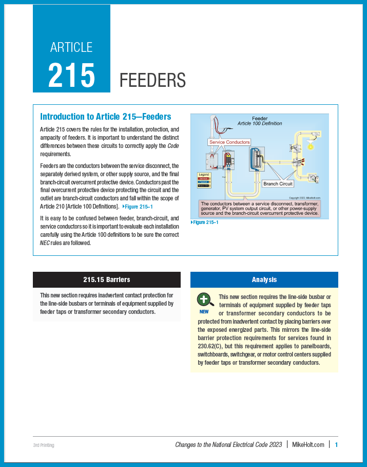

Click here or on the thumbnail to view or download the PDF of this rule. (2 pages, 969 KB)
Did you know that even if you open the disconnecting means for equipment supplied by feeder taps or transformer secondary conductors you might be exposed to energized parts?
A new rule, 215.15 in the 2023 NEC, now requires line side barriers for feeders to help protect against inadvertent contact with energized parts.

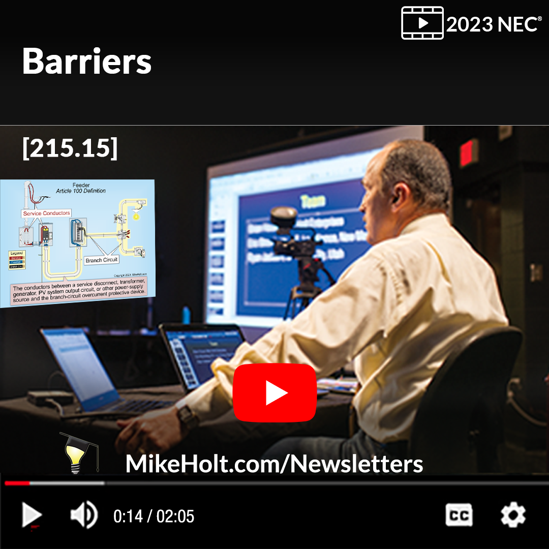

Check out the attached article then watch the video where Mike and the team discuss what is required in this new section.
