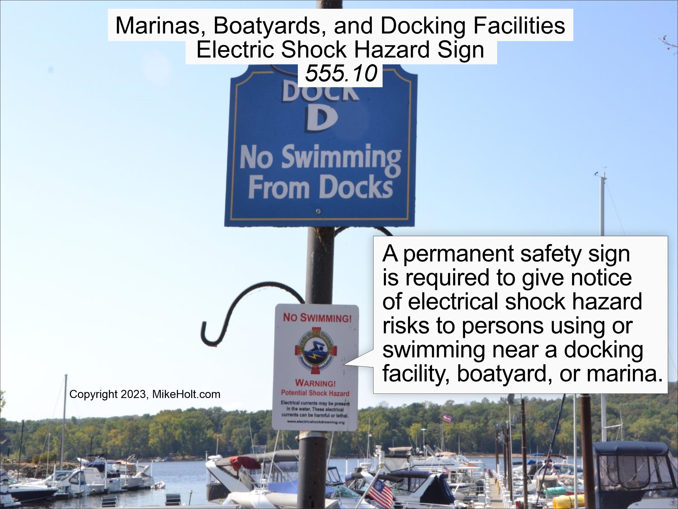

A permanent safety sign is required. It must give notice of electrical shock hazard risks to persons using or swimming near a docking facility, boatyard, or marina. The safety sign must meet all the requirements of 555.10. For example, it must be clearly visible from all approaches to a marina or boatyard facility. Figure 01
