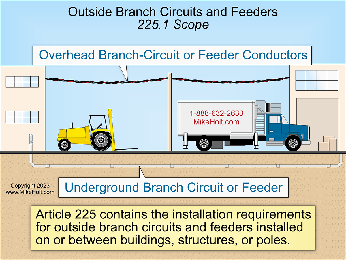

Figure 01
Article 225 contains requirements for outside branch circuits and feeders not over 1000V ac or 1500V dc, installed on or between buildings, structures, or poles. Figure 01
Conductors installed outdoors can serve many purposes such as lighting and power for outdoor equipment, or to provide power to separate buildings.
