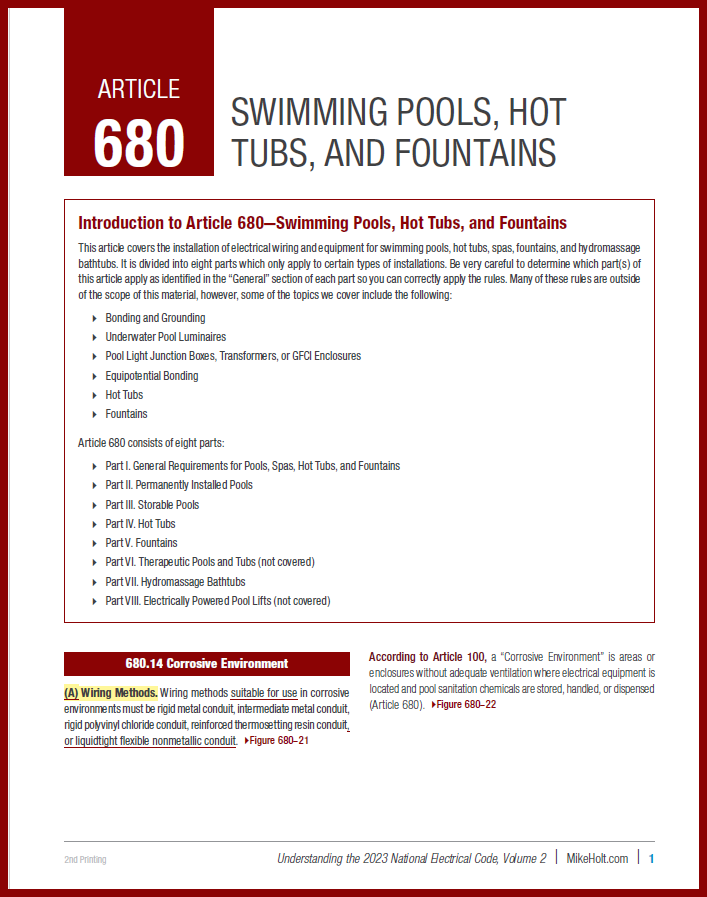

This content is extracted from Mike Holt's 2023 Understanding the National Electrical Code Volume 2 Video Program.
Click here or on the thumbnail to view or download the PDF of this rule.
Corrosive environments that can damage electrical equipment and installations are everywhere. Perhaps some of the most corrosive are areas involving swimming pools, hot tubs, and fountains. With constant exposure to moisture and chemicals in these environments, special consideration needs to be given to the wiring methods involved.
Learn what the National Electrical Code has to say regarding these particular corrosive environments by reading the attached text and watching the video as Mike and the team discuss the requirements in NEC section 680.14.
