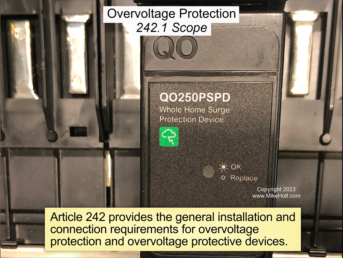

To protect against transient overvoltage, you need a surge protection device (SPD).
An SPD limits transient overvoltages by diverting or limiting surge current and preventing its continued flow while remaining capable of repeating these functions [100]. Article 242 provides the general, installation, and connection requirements for overvoltage protection and SPDs. Figure 01

An SPD must be listed [242.6]. The SPD must be marked with its short-circuit current rating and cannot be installed where the available fault current exceeds that rating [242.8].
SPDs are susceptible to failure at high fault currents. A hazardous condition is present if the short-circuit current rating of an SPD is less than the available fault current. To understand more about this, we turn to 110.10. This has a long first sentence, the crux of which is the protective devices must be selected and coordinated so they can clear a fault without extensive damage to the equipment.
An SPD must indicate that it is functioning properly [242.9]. When you install an SPD, ensure this indication is readily visible without needing to move aside conductors or to stand on one’s head to see it.
