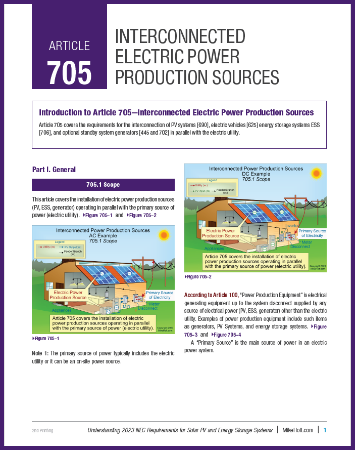

Click here or on the thumbnail to view or download the PDF of this rule. (2 pages, 1,340 KB)
