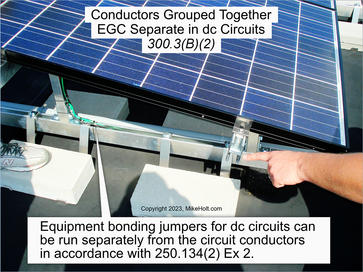

Figure 01
Single conductors specified in Table 310.4(1) must be installed in a Chapter 3 wiring method [300.3(A)]. All conductors of a circuit, including the neutral and equipment grounding conductors, must be installed in the same raceway, cable, trench, or cable tray except as permitted by 300.3(B)(1) through (4). For example, you can run grounding and bonding conductors outside a raceway or cable assembly. Figure 01
