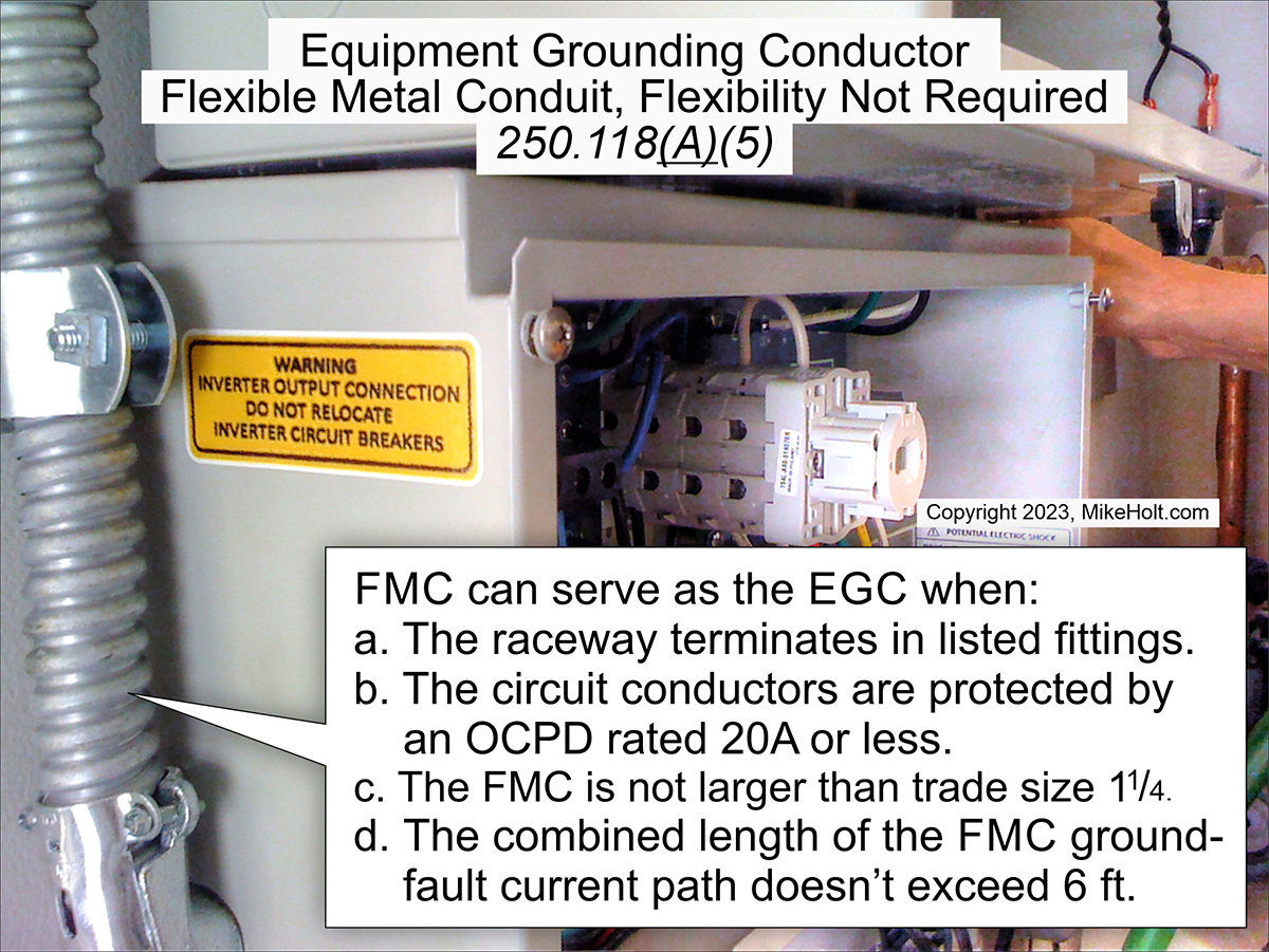

Where electrically and mechanically continuous, all types of metal raceway can be used as an Equipment Grounding Conductor (EGC) [250.118].
They make better EGCs than wire conductors do, because their much larger surface area will carry high frequency current via the skin effect. Figure 01

If flexibility is necessary to minimize the transmission of vibration from equipment, or to provide flexibility for equipment that requires movement after installation, choose a flexible raceway for the last few feet. Running a non-flexible raceway to a big pump, for example, guarantees something will break. Maybe a raceway connector will loosen (and start a corrosion process if threaded) or maybe the equipment will be damaged.
When using a flexible raceway, an EGC of the wire-type must be installed with the circuit conductors [348.60 and 350.60] or the length must not exceed 6 ft [250.118.5.d, 6.d, 7.b].
If an EGC is installed outside the flexible metal raceway, it can be no longer than 6ft and must be routed with the flexible metal raceway per 250.102(E)(2). So to go beyond 6ft, install the wire-type EGC inside the metal raceway.
