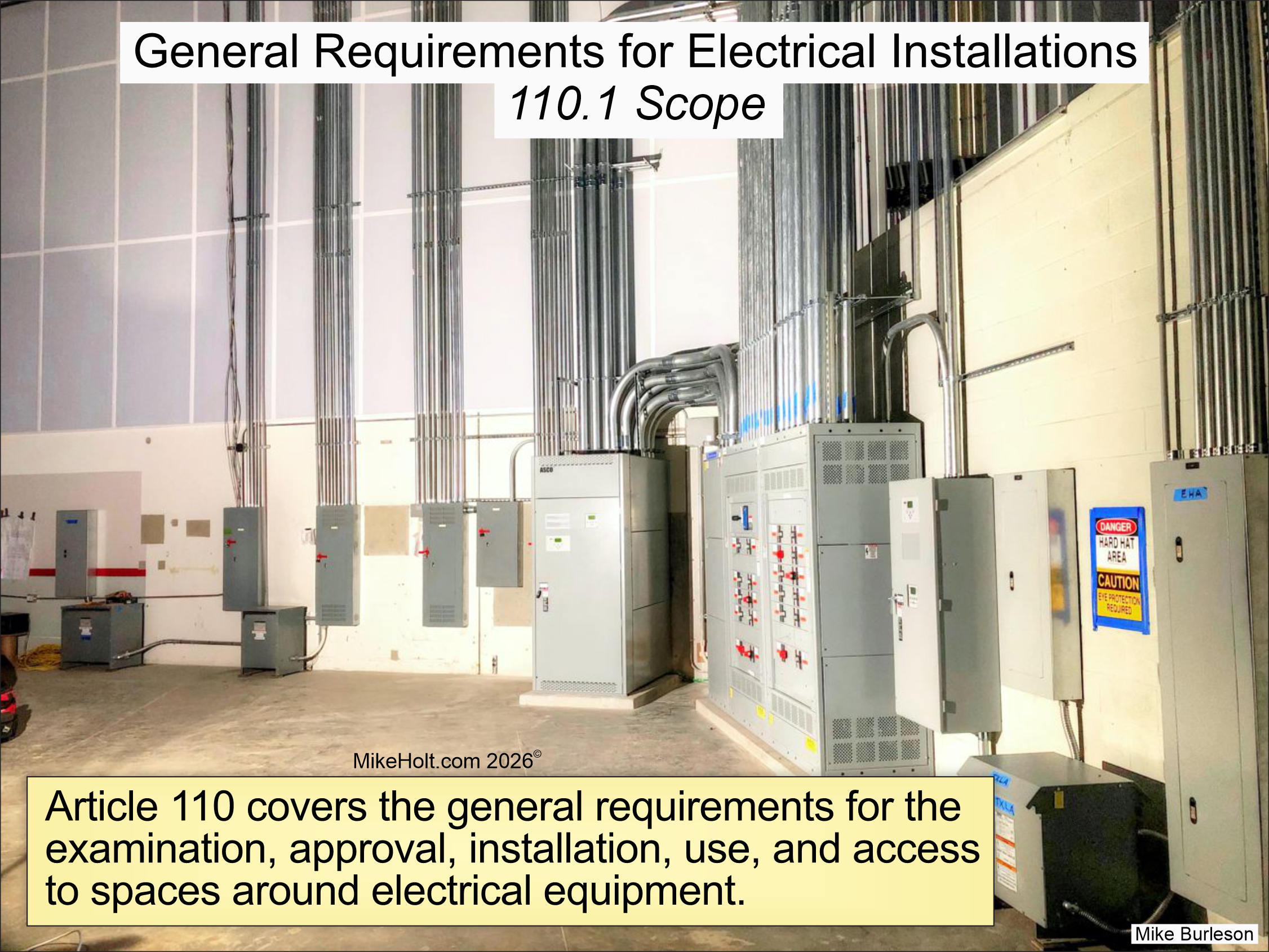

Article 110 covers the general requirements for the examination, approval, installation, and use of electrical equipment plus the spaces around it. These requirements apply to all installations, except as amended elsewhere in the Code. Figure 01

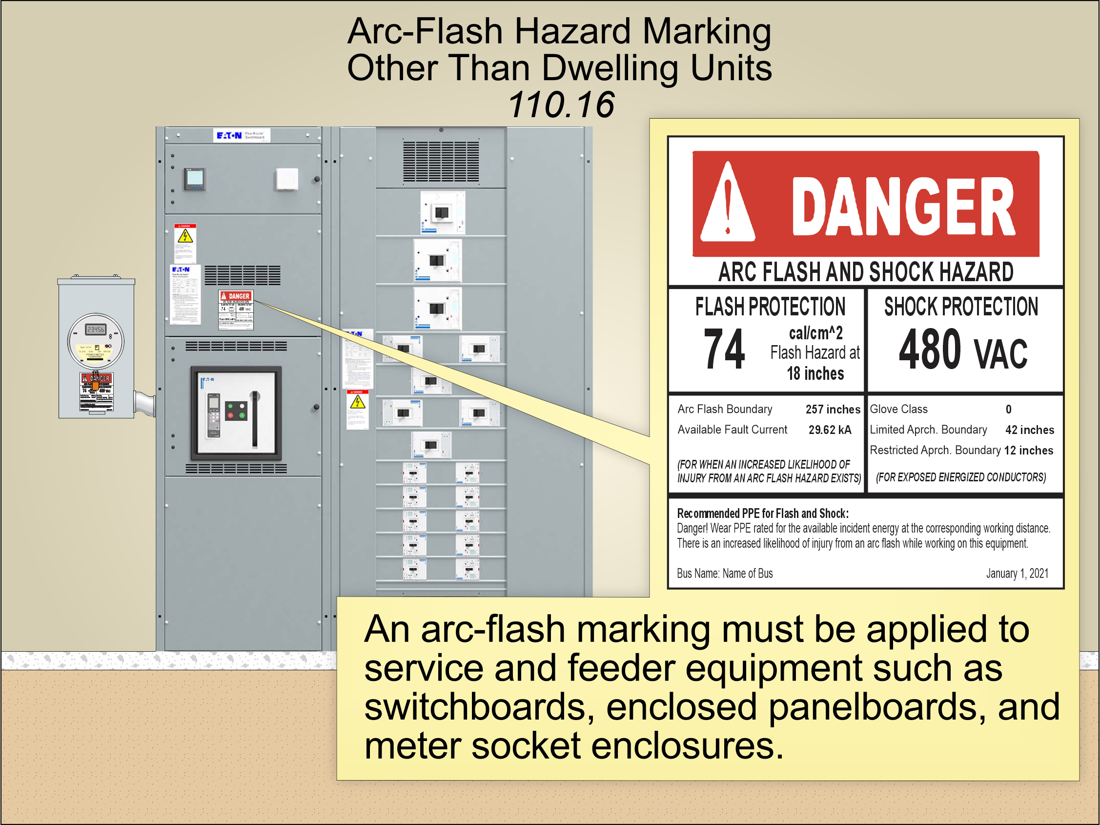

In other than dwelling units:
  • A permanent arc-flash marking must be applied to service and feeder equipment such as switchboards, enclosed panelboards, and meter socket enclosures [110.16]. Figure 02

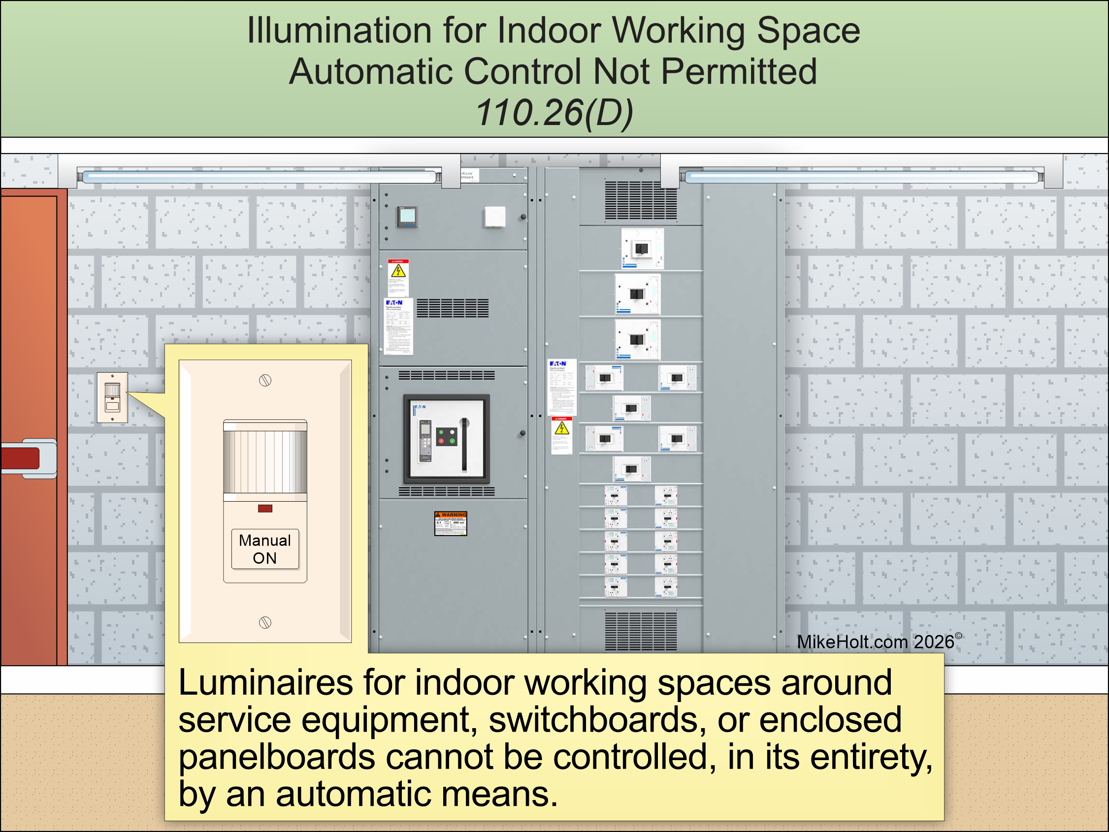

Illumination
Illumination is required for indoor working spaces about service equipment, switchboards, or enclosed panelboards [110.24(D)]. This illumination cannot be totally controlled by automatic means. Figure 03
