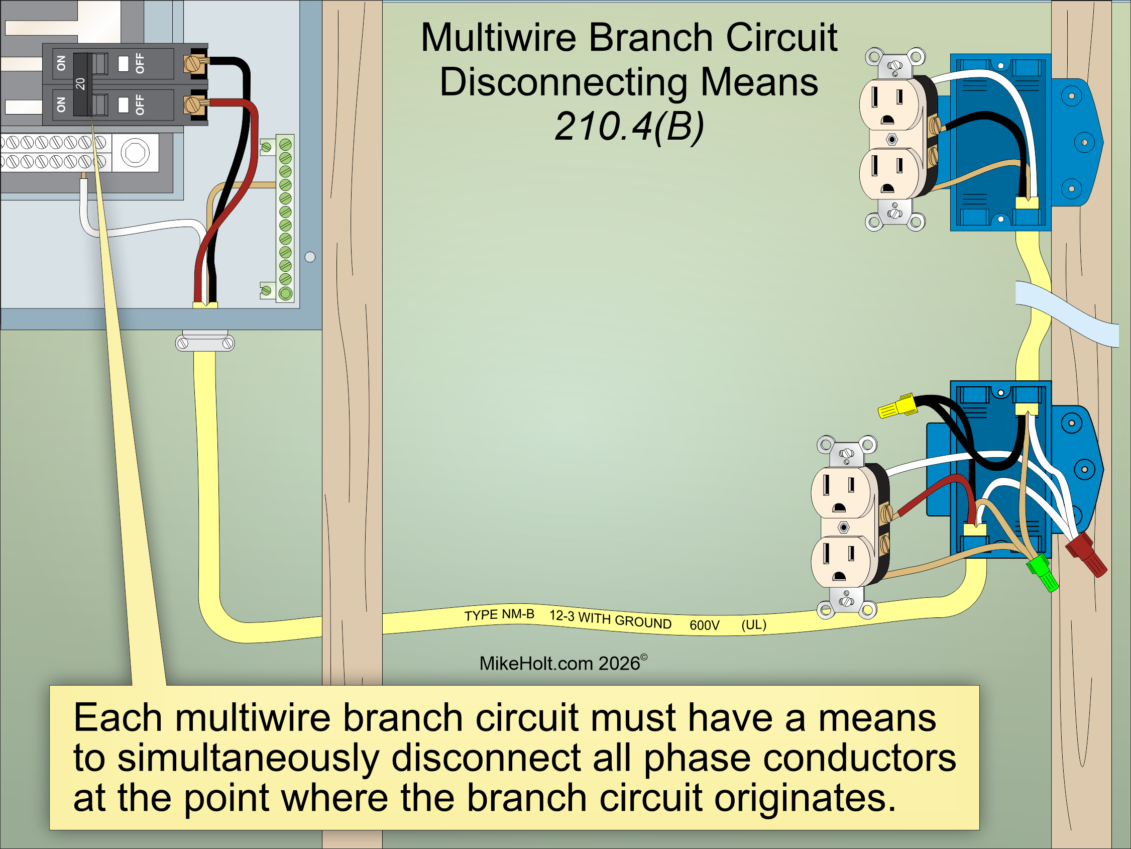

Multiwire Branch Circuits
In accordance with Article 100 a “multiwire branch circuit” is defined as a branch circuit consisting of two or more phase conductors with a neutral conductor having a voltage between the phase conductors and equal voltage from each phase conductor to the neutral conductor.
A multiwire branch circuit can be considered as multiple circuits [210.4(A)]. All conductors of a multiwire branch circuit must originate from the same equipment containing the overcurrent protective devices. The neutral conductor of a multiwire branch circuit is not permitted to be interrupted by the removal of a wiring device [210.4(A) Note 2].
Each multiwire branch circuit must have a means to simultaneously disconnect all phase conductors at the point where the circuit originates [210.4(B)]. Figure 01
This rule is intended to prevent people from working on energized circuits they thought were disconnected. Additionally, failure to terminate the phase conductors to separate phases within the panelboard can cause the neutral conductor to become overloaded.
Multiwire branch circuits must supply only line-to-neutral loads [210.4(C)], but there are two exceptions.
The phase and neutral conductors of a multiwire branch circuit must be grouped or identified together by cable ties, wire markers, or similar means within each enclosure per 200.6(B) [210.4(D)]. Grouping is not required if multiwire branch-circuit conductors pass through a box without splices or terminations [200.6(B) Ex 2].

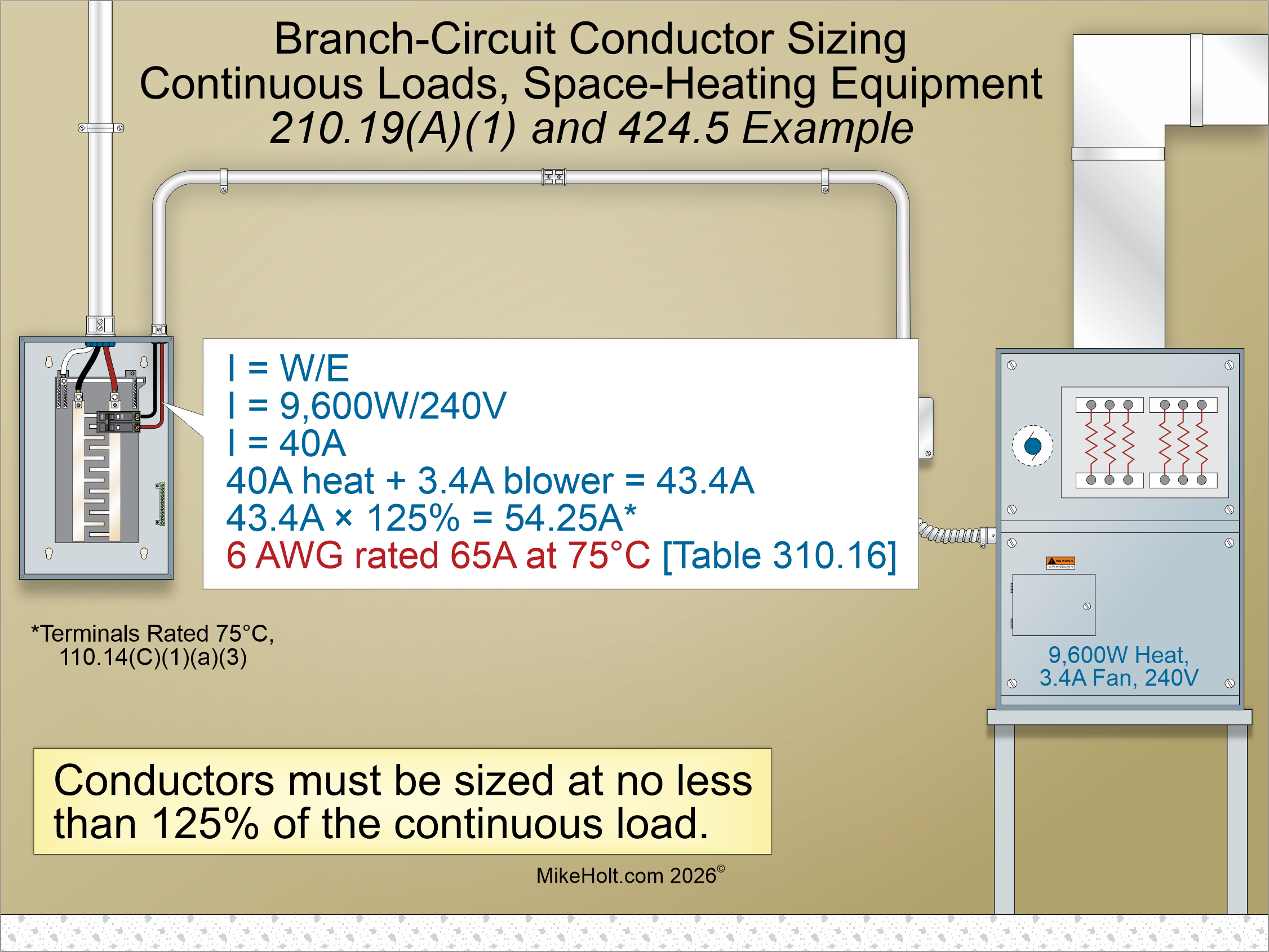

(1) Continuous and noncontinuous loads. Branch circuit conductors must have an ampacity no less than 125 percent of the continuous loads, plus 100 percent of the noncontinuous loads.
Question: What size conductor is required for a 9,600W, 240V fixed electric space heater with a 3.4A, 240V blower motor where the equipment terminations are rated 75°C? Note: A fixed electric space heater is considered a continuous load in accordance with 424.5. 
(a) 8 AWG (b) 6 AWG (c) 4 AWG (d) 3 AWG
Figure 02
Solution:
Step 1: Determine the total load.
I = Watts/Volts
I = 9,600W/240V
I = 40A
Circuit Current = 40A (heat) + 3.4A (blower)
Circuit Current = 43.4A
Step 2: Size the conductors at 125 percent of the total current load [210.19(A)(1) and 424.5(B)].
Conductor = 43.4A × 125%
Conductor = 54.25A
Conductor = 6 AWG rated 65A at 75°C [Table 310.16 and 110.14(C)(1)(a)(3)].
Answer: (b) 6 AWG

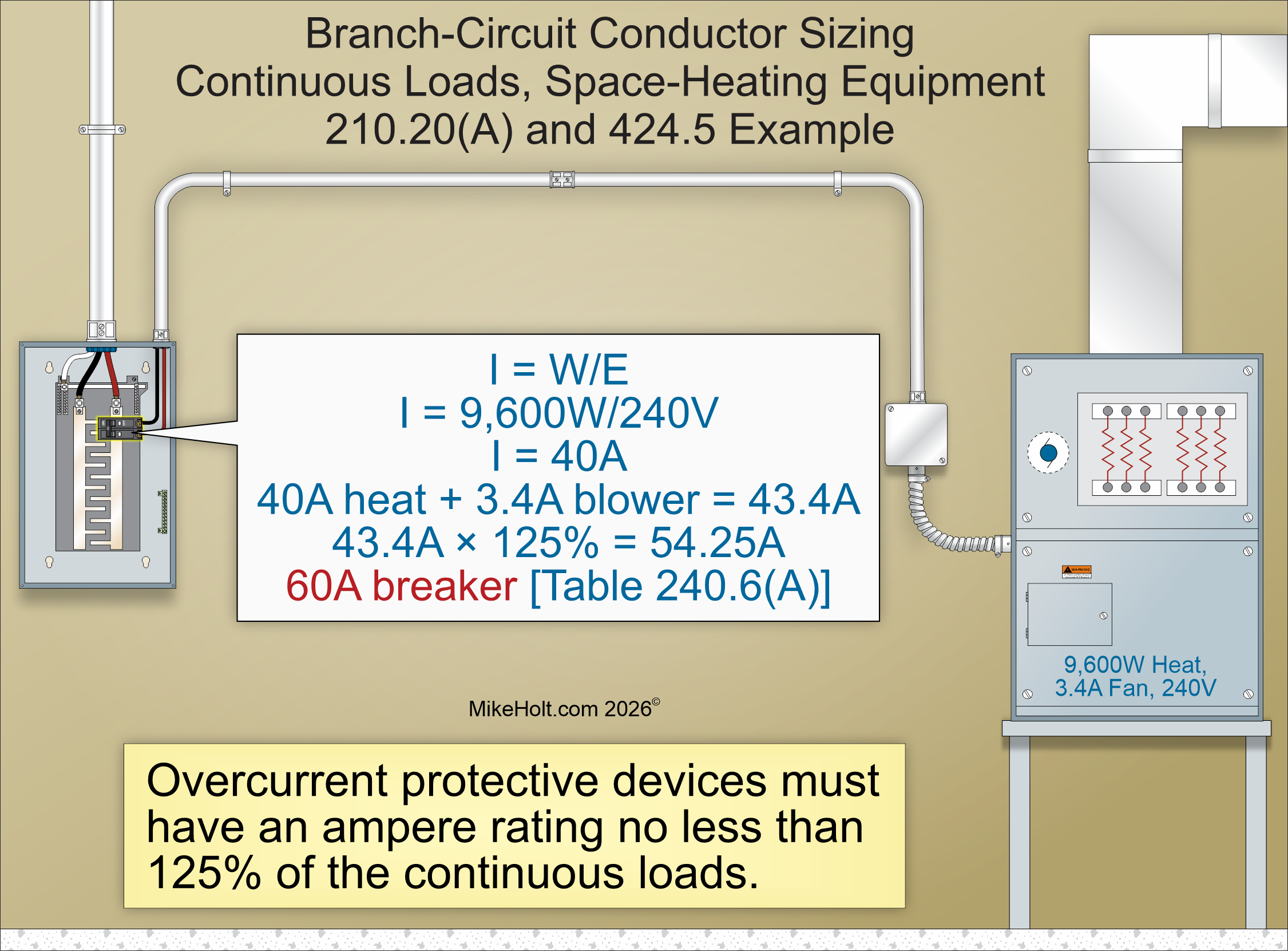

Branch Circuit Overcurrent Protection
The overcurrent protective device must have an ampere rating not less than 125 percent of the continuous loads, plus 100 percent of the noncontinuous loads [210.20(A)].
Question: What size circuit breaker is required for a 9,600W, 240V fixed electric space heater with a 3.4A, 240V blower motor? Note: A fixed electric space heater is considered a continuous load in accordance with 424.5.
(a) 40A (b) 45A (c) 50A (d) 60A
Figure 03
Solution:
I = Watts/Volts
I = 9,600W/240V
I = 40A
Step 2: Size the OCPD at 125 percent of the continuous load [424.5]
Protection Rating = 43.4A × 125%
Protection Rating = 54.25A
60A circuit breaker [Table 240.6(A)]
Answer: (d) 60A
