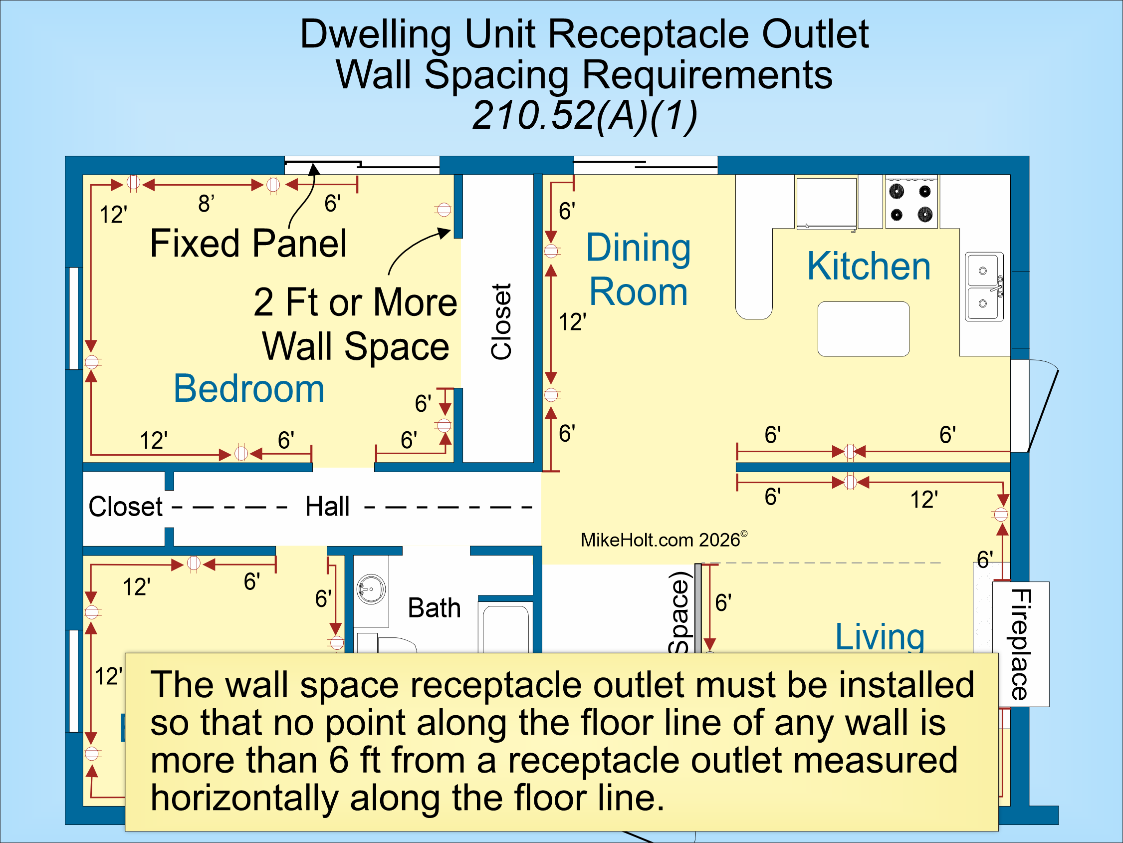

Dwelling Unit Wall Space Receptacle Outlets
A receptacle outlet must be installed along the walls of every kitchen, family room, dining room, living room, sunroom, parlor, library, den, bedroom, recreation room, and similar areas per the requirements of 210.52(A)(1) through (5).
The wall space receptacle outlet must be installed so that no point along the floor line of any wall is more than 6 ft from a receptacle outlet measured horizontally along the floor line [210.52(A)(1)]. Figure 01
A wall space as used in this rule includes the following [210.52(A)(2)(1) through (3)]:
  • A wall space 2 ft or more in width unbroken along the floor line
  • The space occupied by fixed panels
  • The space occupied by fixed room dividers, freestanding bar-type counters, or railings.

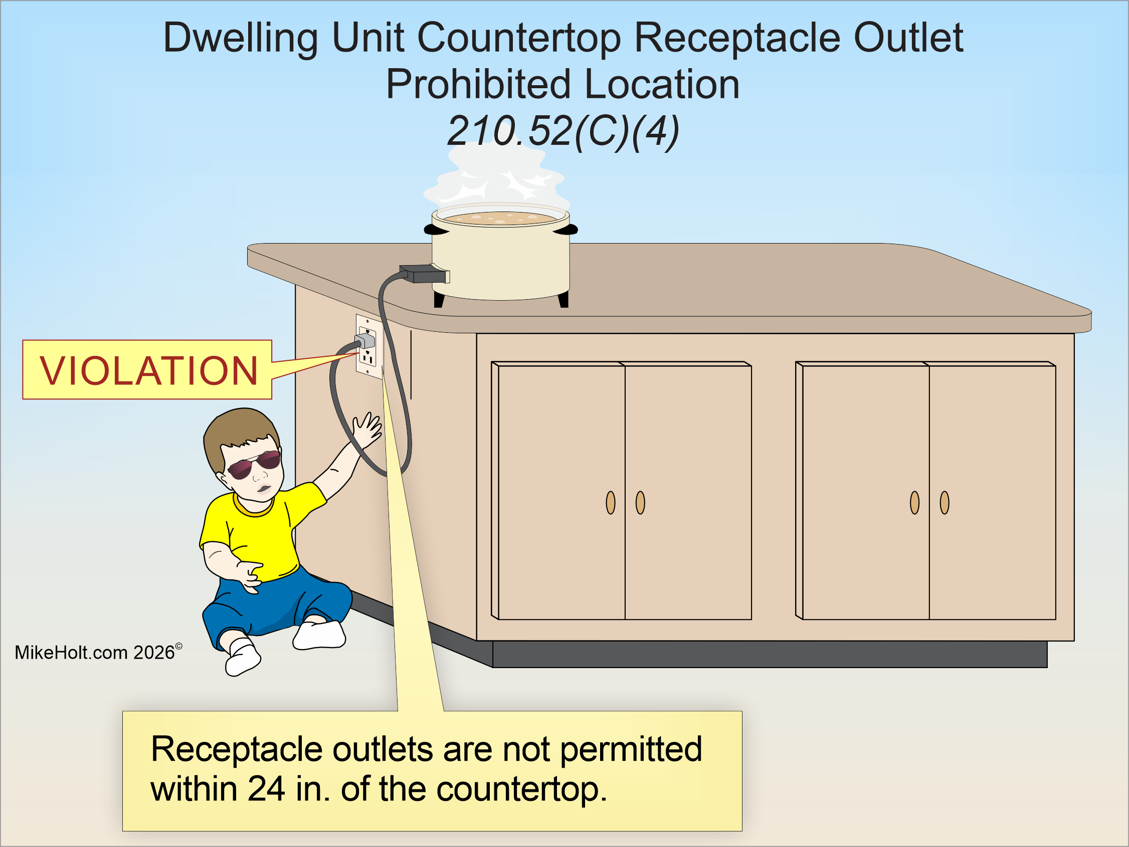

In dwelling unit kitchens, pantries, breakfast rooms, and dining rooms, receptacle outlets must be installed for countertops 12 in. or wider and meet the following requirements:
The countertop receptacle outlets cannot be used to meet the wall space receptacle outlets required by 210.52(A) [210.52(C)].
The countertop receptacle outlet must be placed so that no point along the wall space is more than 2 ft from a receptacle outlet, as measured horizontally [210.52(C)(1)].
A receptacle outlet is not required for island or peninsular counter tops. If a receptacle outlet is not installed, electrical provisions for the future addition of a receptacle outlet is required [210.52(C)(2)].
A receptacle outlet at island or peninsular countertops, if installed, must be located above or within the countertop as follows [210.52(C)(3)]:
  • Receptacle outlets can be on or not more than 20 in. above the countertop.
  • Receptacle outlets on the counter-top surface must be a receptacle outlet assembly listed for use on a counter-top.
Receptacle outlets are not permitted to be located within 24 in. below the countertop surface [210.52(C)(4)]. Figure 02

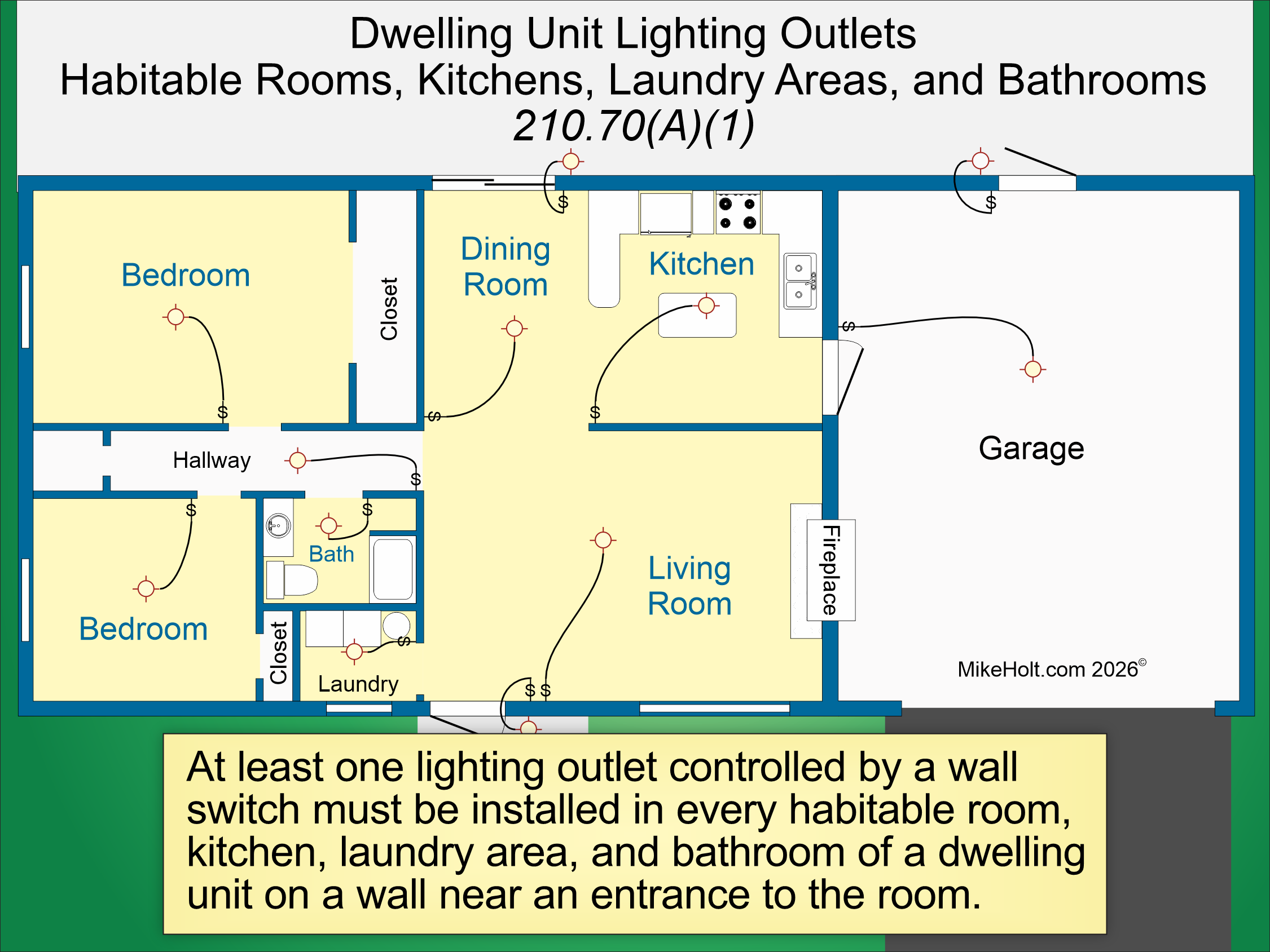

Dwelling Unit Lighting Outlets
At least one lighting outlet controlled by a wall switch must be installed in every habitable room, kitchen, laundry area, and bathroom. The wall switch must be on a wall near an entrance to the room [210.70(A)(1)]. Figure 03
At least one lighting outlet controlled by a wall switch must be installed in hallways, stairways, garages, and accessory buildings with electric power [210.70(A)(2)].
