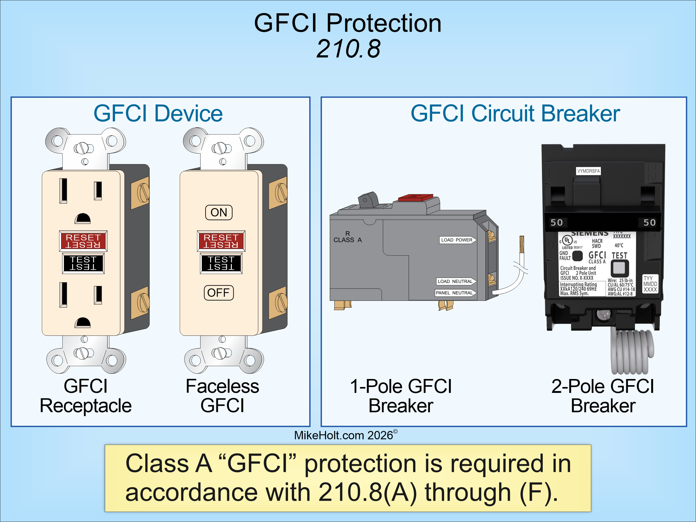

GFCI General Requirements
GFCI protection as required in 210.8(A) through (F) must comply with the following: Figure 01
Figure 01
The GFCI device must be in a readily accessible location [210.8]. This is important for monthly testing as recommended by the manufacturer's instructions.
Note: Readily accessible is defined as capable of being reached quickly for operation, renewal, or inspection without those requiring ready access to take actions, such as the use of tools (other than keys), climbing over or under obstructions, removing obstacles, or requiring the use of portable ladders [Article 100].
GFCI protection can be provided by a GFCI circuit breaker or a GFCI receptacle.

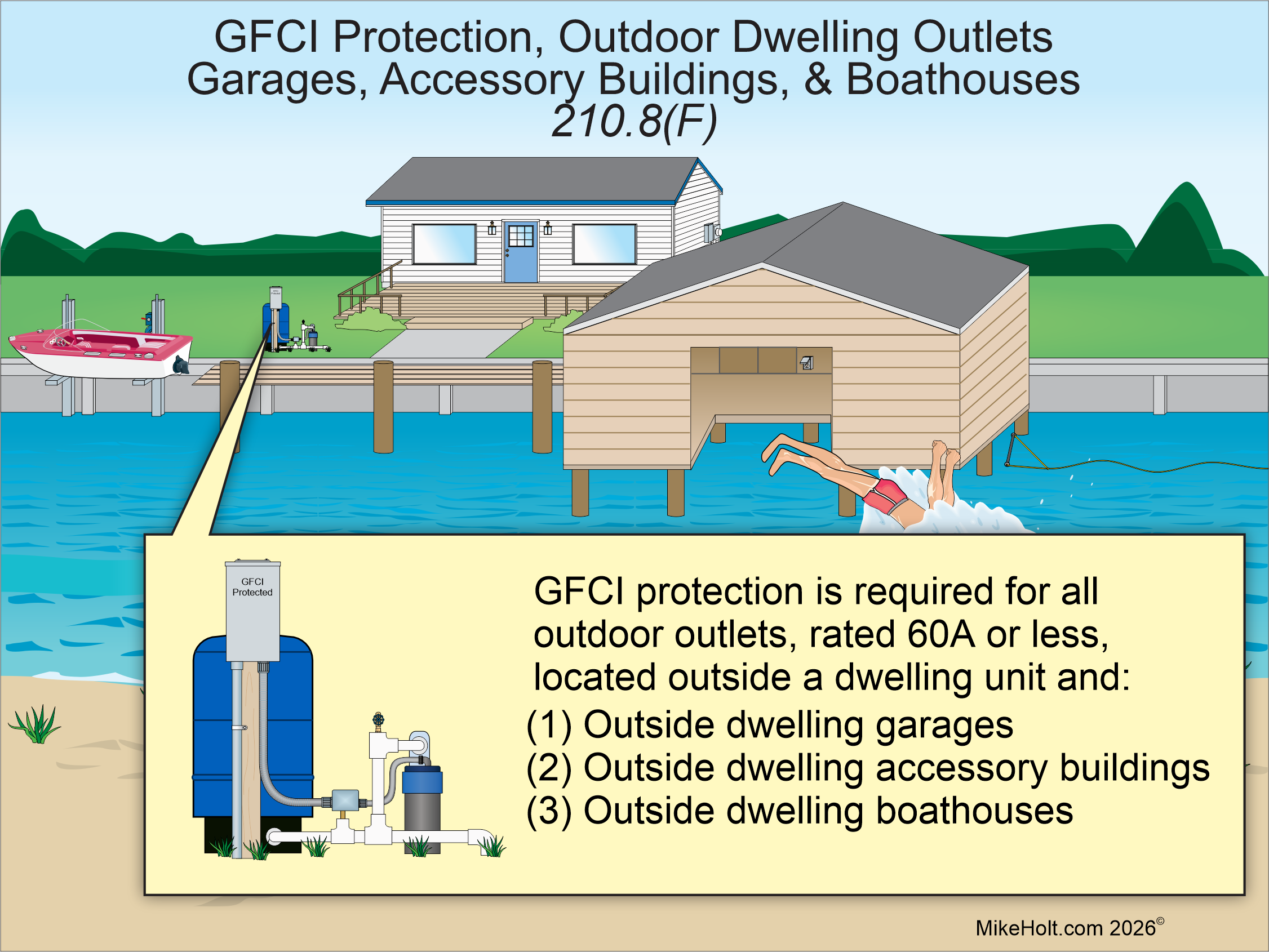

GFCI Protection for Dwelling Outdoor Equipment
GFCI protection is required for all outlets for electrical equipment, such as HVAC, pumps, etc., rated 60A or less, outside a dwelling unit, outside dwelling garages, outside dwelling accessory buildings, and outside dwelling boathouses [210.8(F)]. Figure 02
Figure 02
Note: Class A GFCIs marked "HF" are evaluated for use with loads having high-frequency leakage currents from power conversion components such as variable-speed drives and inverters. See UL 943, Ground-Fault Circuit-Interrupters, for further information [210.8 Note 2].
Equipment Replacement. If equipment connected to any dwelling outdoor outlets is replaced, the circuit to the outlet must be GFCI-protected.

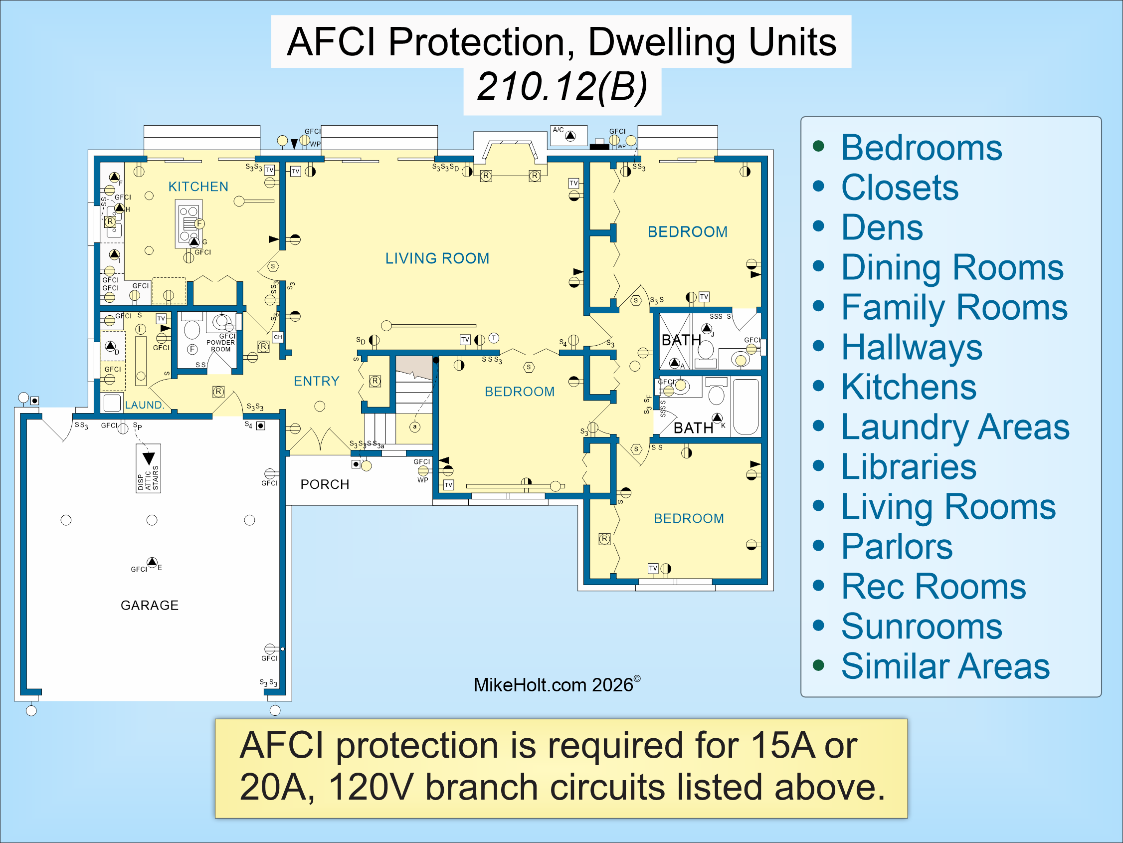

AFCI Requirements
AFCI protection as required in 210.12(B) through (E) must be in a readily accessible location and comply with the following:
AFCI Protection for Dwelling Units
AFCI protection is required for 15A or 20A, 120V branch circuits in the following dwelling unit locations [210.12(B)]:
(1) Kitchens
(2) Family rooms
(3) Dining rooms
(4) Living rooms
(5) Parlors
(6) Libraries
(7) Dens
(8) Bedrooms
(9) Sunrooms
(10) Recreation rooms
(11) Closets
(12) Hallways
(13) Laundry areas
(14) Similar areas Figure 03
