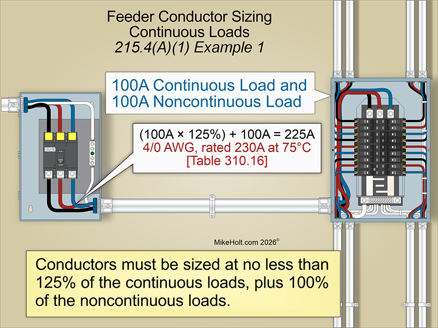

Conductor Sizing
The ampacity of the feeder conductors must be no less than 125 percent of the continuous loads, plus 100 percent of the noncontinuous loads.
Example 1: Continuous and Noncontinuous Loads
Question: What size copper feeder conductors are required for a 100A continuous load and 100A noncontinuous load?
(a) 1/0 AWG (b) 2/0 AWG (c) 3/0 AWG (d) 4/0 AWG
Figure 01
Figure 01
Solution:
Step 1: Determine the minimum conductor ampacity.
Minimum Conductor Ampacity = (100A × 125%) + 100A
Minimum Conductor Ampacity = 125A + 100A
Minimum Conductor Ampacity = 225A
Step 2: Determine the conductor size.
4/0 AWG rated 230A, 75°C column of Table 310.16
Answer: (d) 4/0 AWG

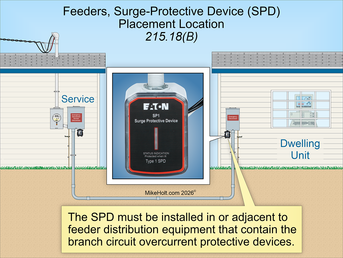

Surge Protection
If a feeder supplies any of the following areas, a Type 1 or Type 2 SPD is required [215.18(A)]:
(1) Dwelling units.
(2) Dormitories.
(3) Guest rooms and guest suites of hotels, motels, and dormitories.
(4) Areas of nursing homes and limited care facilities used exclusively as patient sleeping rooms.
(5) Areas for sleeping quarters in fire stations, police stations, rescue stations, ambulance stations, ranger stations, and similar locations.
The SPD must be installed in or adjacent to the feeder distribution equipment containing the branch circuit overcurrent protective devices [215.18(B)]. Figure 03
Figure 03
Surge protection from surges generated from lightning, electric utility, or utilization equipment is most effective when located closest to the branch circuits [215.18(B) Note].
Surge protection helps protect life-safety electronic equipment like AFCIs, GFCIs, and smoke alarms.
Where feeder-supplied distribution equipment is replaced in dwelling units, dormitories, guest rooms and guest suites of hotels or motels, and areas of nursing homes and limited care facilities used exclusively as patient sleeping rooms, an SPD is required [215.18(D)].
SPDs must have a nominal discharge current rating (In) at least 10 kA [215.18(E)].
