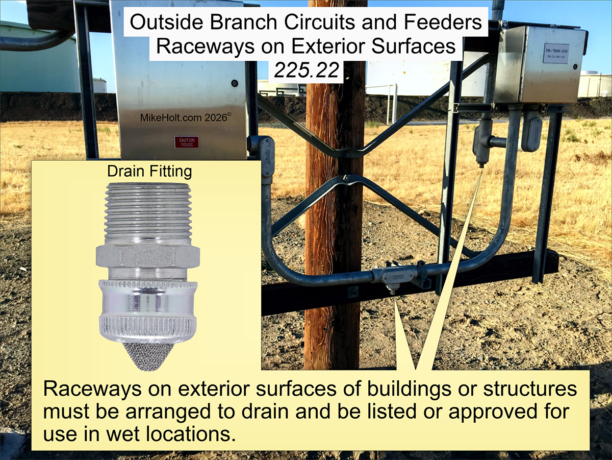

Outside Raceways
Raceways on exterior surfaces of buildings or structures must be arranged to drain [225.22]. Figure 02
Figure 02
Note: Get with your AHJ on this rule!

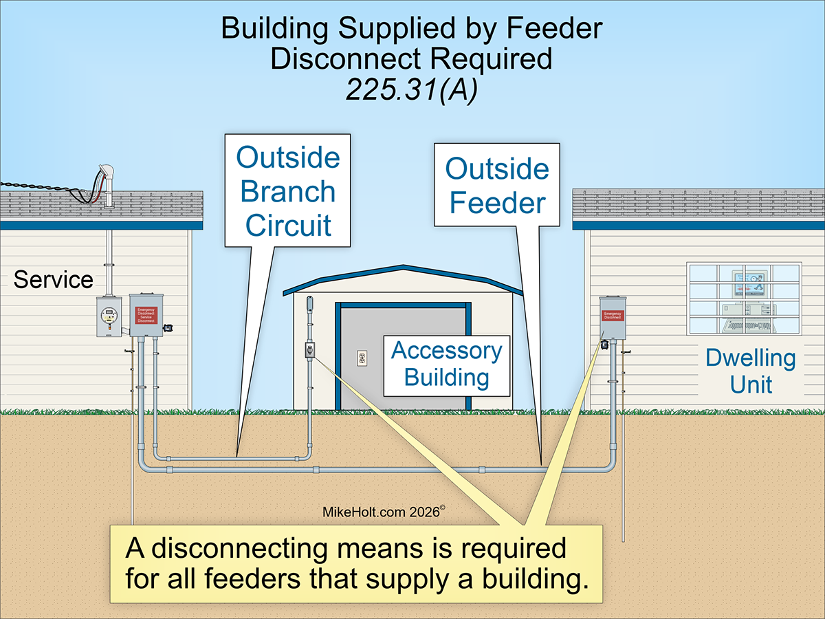

Disconnecting Means
A disconnecting means is required for all feeders that supply a building or structure [225.31(A)].
Figure 03
Figure 03
Inside. The feeder disconnect can be located inside the building nearest the point of entrance of the feeder conductors [225.31(B)].
Outside. If the feeder disconnect is located outside of the building, the disconnecting means can be on or within sight of and not more than 50 ft from the building [225.31(B)].
Feeder conductors under at least 2 in. of concrete or encased in at least 2 in. of concrete are considered outside a building [225.31(B)].
