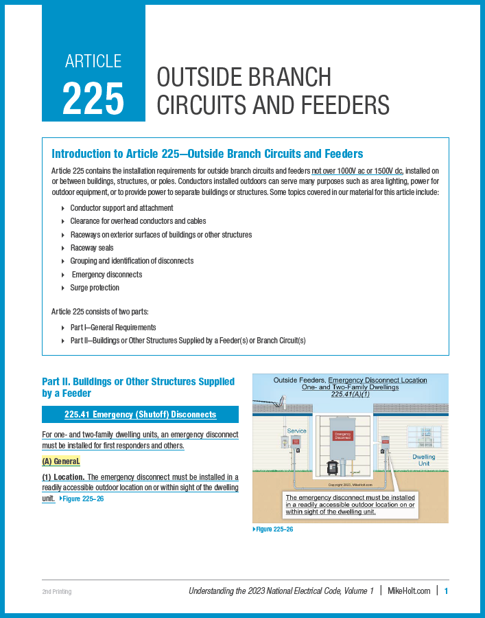

Click here or on the thumbnail to view or download the PDF of this rule. (2 pages, 93.7 KB)
One- and two-family dwelling units typically receive their main electrical power through service entrance conductors which require an emergency disconnect outside of the dwelling unit. But what if those conductors are classified as “feeders” instead of service conductors.
Do we still need an emergency disconnect?
Find out by reading the attached text and then watching the video where Mike and the team explain.
