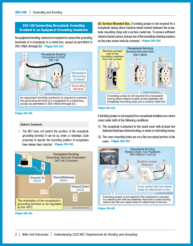

Click here or on the thumbnail to view or download the PDF of this rule.
Is a grounding pigtail always required from the receptacle to a metal box? You might be surprised what the Code actually says — sometimes you do, sometimes you don’t.
I know you’ve probably been told in the field that you always need one… but that’s not always true. Knowing the real rules can save you time and money on the job.
Want to know when you need it and when you don’t? Check out the text and video where Mike and the team break down NEC 250.146.
