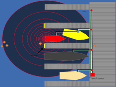

Marina dock electrical hazard
Marina / dock electrical hazard - Courtesy of ESDPA
Would you consider stepping into a bathtub or swimming pool with a hair dryer? Think of the boat as the hairdryer. If an electric fault occurs on a boat while it is connected to a marina's or dock's shore power and the boat or marina is not properly wired to meet current ABYC and NFPA standards, the water surrounding the boat will become electrified.
Ground fault leakage into the water causes electrical gradients to form. If a person gets in one of these gradients, a current will flow through the body. Currents as low as 10ma can cause paralysis of limbs preventing a person from staying afloat, resulting in drowning (for comparison a 60 watt light bulb draws 500ma). Higher currents can cause the heart to fail directly resulting in death. There is no warning of this situation, and there is no post-mortem indication available absent any burn marks associated with direct contact with an electrical source. Witness reports (from touching the water or hearing the victim shouting they are getting shocked) often substantiate the presence of electricity on the water.
This is predominantly a low-conductivity-water phenomenon. When water gets saltier or higher in conductivity it competes for the current flow path more favorably than the body, so the current appears to go around the body. In freshwaters the body is more conductive than the water so electrical gradients can establish and act as a voltage source to drive current through the body.
