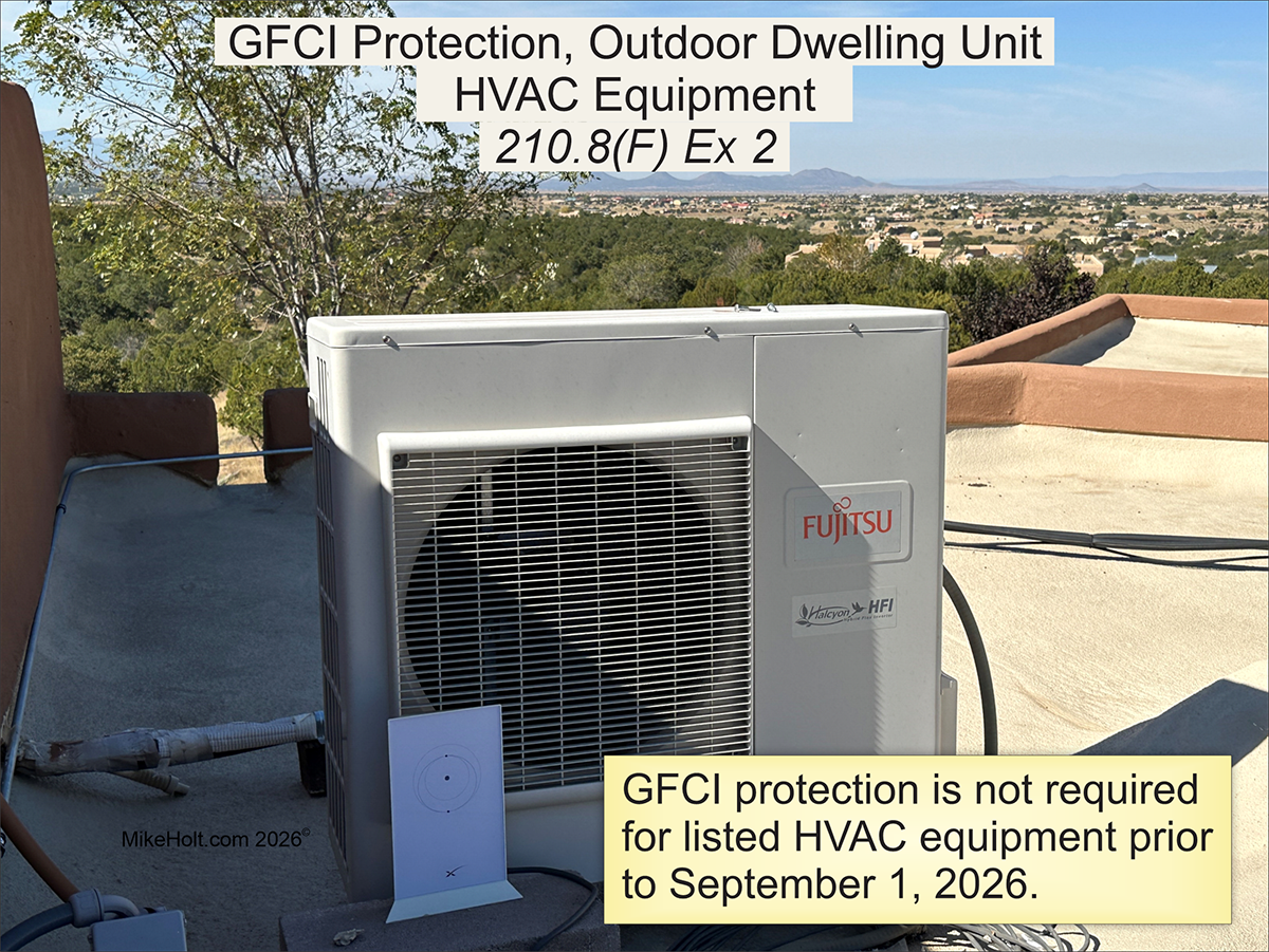

High-frequency compatible GFCI devices have been introduced by some manufacturers, while others have publicly indicated that development efforts remain ongoing. Even as these products are brought to market, broad availability and adoption throughout the electrical supply chain will take time. In addition, work within UL 943 continues as industry stakeholders evaluate the lessons learned from recent research and real-world experience. UL 943 currently includes optional high-frequency performance requirements, and work is underway to incorporate mandatory high-frequency requirements into a future revision of the standard. That work remains ongoing.
Why Additional Time Is Being Requested
AHRI has submitted TIA 1924, which would extend the HVAC equipment exemption currently associated with NEC 210.8(F) through September 1, 2028. The proposal is intended to provide time for the findings of Project 8029 to be incorporated into equipment designs, product standards, certification programs, and commercially available GFCI products.
