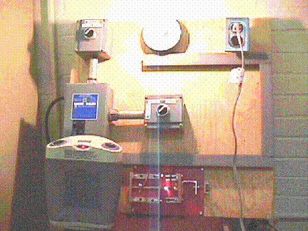

The Plant Protection Electrical Safety Team at a large chemical manufacturing company, in cooperation with their resident electrical contractor, designed and built a test set-up to demonstrate AFCI actual arc fault tripping.  The intention in building this rig was to provide a demonstration for instructional purposes at the local Area Safety Council Workshop, held annually.  The following circuit diagram shows the device that was built.
The set-up consisted of a 2-circuit distribution panel, with a standard 20-ampere circuit breaker in one slot and an AFCI in the other slot.  The panel was fed by a standard 115 VAC outlet through a cord and plug arrangement.  A switch (SW-1) was placed (three-pole / double-throw) on the input and output from the distribution panel so that either the standard circuit breaker or the AFCI breaker was feeding the load(s).  The other pole was used to feed the current either directly in to the neutral bus of the distribution center, or through the AFCI neutral connection.  A set of adjustable carbon-arc rods (AR-1) was mounted at the load side of the distribution panel, so that current to the load(s) was forced to flow through them.  By adjusting the spacing between the rods, an arc could be established and maintained.  Loads were attached to the set-up either by the hard-wired lamp holder, or the duplex receptacle.  Loads consisted of a heat gun (very similar to a hair dryer) rated at 1500 Watts, an electric drill which had a 2.4 ampere current draw, and a 205 Watt incandescent light bulb.  Various combinations of these loads were tried.
Two Manufacturer ‘B’ AFCIs and one Manufacturer ‘A’ AFCI were used in the test set-up.

Carbon-arc rods were adjusted so that they made contact with each other.  Switches were placed in a position such that current flow went through the AFCI device.  Loads were activated (heat gun or heater turned on; drill started; bulb inserted), and the carbon rods were adjusted so that a sustainable arc was established.  AT NO TIME DURING THIS PROCEDURE DID THE AFCIs EVER TRIP OFF.
We became concerned when we could not manage to trip the AFCI no matter how the carbon rods were adjusted.  A second Manufacturer ‘B’  AFCI was tried, with exactly the same results the AFCI simply would not trip, despite the fact that we had a beautiful, sputtering, arc between the carbon-arc rods.  A Manufacturer ‘A’ AFCI was tried same results.  For all AFCIs, when the blue test button was pressed, the device did indeed trip; it appeared that the only way to make these AFCI devices trip was with the test button!

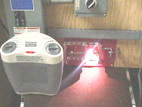

Carbon-Arc Rods with series arc occurring
Close-up of series arc, with small heater providing load current
