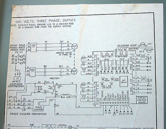

I hope all things are well with you. This photo was taken of a control cabinet we are to hook up on one of our projects. Note that the instructions on the top left side indicate that the equipment must be grounded to a ground rod or a ground wire from the supply service.
Naturally, a ground rod is not suitable to serve as the low-impedance fault-current path to the source necessary to clear a ground fault. I thought you might find this humorous.

Currently the NEC in Article 100 defines the terms "ground" or "grounded" as "connected to the earth or to some conducting body that serves in place of the earth." Yet, the NEC often uses the term "ground" when it really means "bond" (connected to an effective ground-fault path to clear a fault) [250.2 and 250.4(A)(5)].
Grounding - Grounding metal parts to the earth in premises wiring is only useful to provide a path for lightning, shunting high-frequency noise, or reducing static discharge.
Bonding - Bonding all metal parts together and then to the system winding (typically to the X0 terminal of a transformer) is done to provide a low-impedance path to the source (system) to facilitate the opening of the circuit-protection device to remove dangerous voltage on metal parts. In addition, bonding the system to metal parts (typically to the X0 terminal of a transformer) stabilizes the system voltage to the metal parts and it provides a zero system reference (to the metal parts).
It took me over 20 years to figure out that when the NEC, as well as books and magazine articles, state "ground or grounded" they rarely intend that the metal parts be connected to the earth or to some conducting body that serves in place of the earth. Typically, the intent is to have the metal parts "bonded" to a low-impedance path so that fault current can return to the system winding. See the definition of "effective ground-fault path" in 250.2 and review 250.4(A)(3), (4), and (5).
For example: Section 250.86 in the NEC requires metal enclosures and raceways to be "grounded."
Is it really the intent of this Code section that metal enclosures and raceways be grounded to the earth (like with a ground rod)? No, the metal raceway ultimately needs to be bonded to the system winding (transformer or generator), by bonding the metal parts to the "effective ground-fault current path," as defined in 250.2.
I'm very concerned when the term "ground," "grounded, or "grounding" is used to refer to the practice of clearing a line-to-case fault (bonding), because some actually think that connecting metal parts to the earth will serve to assist in clearing a ground-fault, which is false for systems that operate at 600V or less [250.4(A)(5)].
